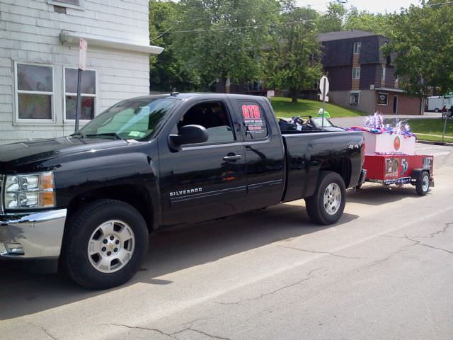

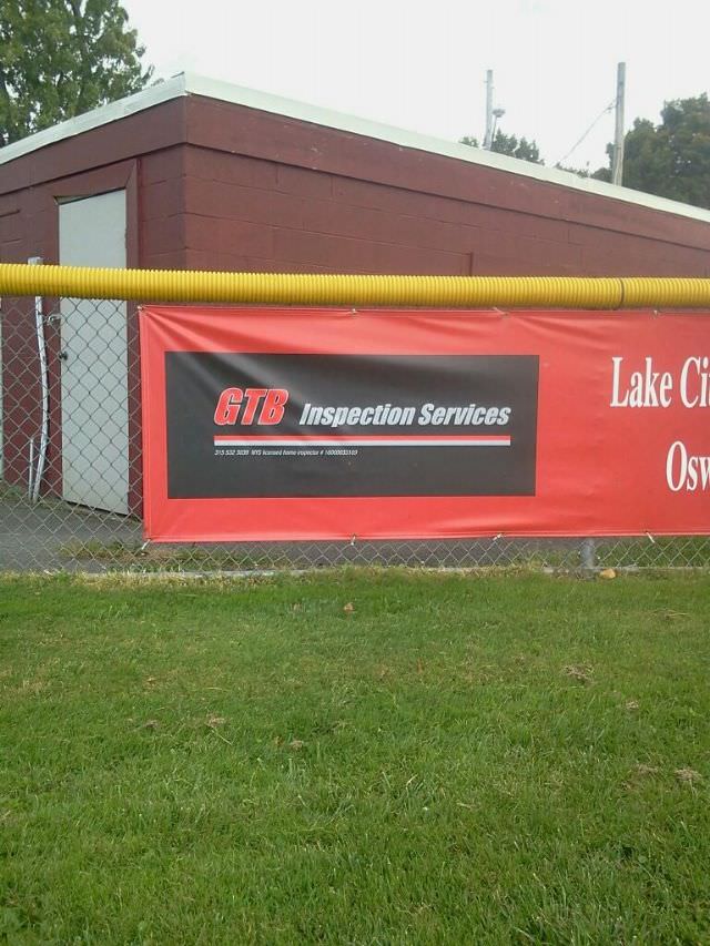

Got Little League baseball?
Click to Enlarge
111.66 KB
Young families buy houses. Any affiliation with kid's sports organizations can generate clients.
Click to Enlarge
60.2 KB
Get involved in local events. Tow the local Chamber of Commerce Independence day parade float. Your vehicle is a moving billboard. Use it.
Buy coffee mugs with your logo printed on them. Big mugs. People love them. They either use them or put them on their desks and fill them with the pens and key chains they get from the other guys. They also end up in workplace break rooms, where they're seen every day.
Business cards. Leave them everywhere. The convenience store counter, the restaurant table, and anywhere you can think of without being charged for littering.
There was a local car salesman who had Buffalo Bills season tickets. The guy brought a banner to all of the games, with his name and number on it. No, "Go Bills" or anything like that. Just his own advertizing. Even got free TV exposure until someone stopped him. He also tossed a handful of cards in the air when they scored. A little extreme, but everyone knew who he was, and it paid him well.
Point is. Don't limit yourself to to old school ideas of pandering and hoping. It's a trap.
You didn't put yourself through school and open your own business with the idea of allowing someone with less knowledge of what you do, be in control of when you do business, right?
Use your imagination. Direct you effort toward those you plan to serve.
Good Luck.
