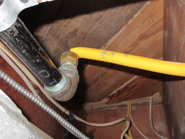

Neal Lewis Posted January 28, 2015 Report Posted January 28, 2015 Found a couple of sections of CSST installed in this manner today. Definitely looks like a potential for leakage. Download Attachment: IMG_6790.JPG 125.25 KB
inspector57 Posted January 28, 2015 Report Posted January 28, 2015 Yep, its wrong. Was the system bonded? A fellow inspector here was sued by the home insurance company after a house burned down.
Darren Posted January 28, 2015 Report Posted January 28, 2015 Hey Neal, Was it bonded correctly. I include this in my reports when CSST isn't bonded. Download Attachment: CSST bonding.pdf 509.05 KB
Neal Lewis Posted January 28, 2015 Author Report Posted January 28, 2015 OK. I'll admit I haven't kept up with the bonding requirements. Does this apply for individual runs as well as when the entire house is piped in CSST? I don't think I've ever seen it grounded before. I'll take a look at the Trac pipe manual. Thanks.

inspector57 Posted January 31, 2015 Report Posted January 31, 2015 When you bond a metal pipe system with a ground wire sized by the circuit likely to energize it, a ground for a 20 amp circuit is plenty. If the 20 amp circuit is attached to the metal pipe, the properly sized ground for that circuit makes a path back from whence it came and trips the breaker. Following the same logic, what is the amperage of a lightening bolt or an induced charge from a nearby strike? Since there is no readily obtainable answer short of a swag, use the size of the largest conductor in the system, the GEC that goes to the ground rod, typically a #6 bare copper wire. Anything smaller and it might not be enough, anything larger and the rest o the GEC and GE may fail. You don't want the bonding conductor to be the weak link. The theory as I understand it is to get the charge into the ground and off of the CSST as quickly and easily as possible. It might not work, but it is worth a shot and there are some studies that have been done on the subject that might shed more light. http://www.nfpa.org/~/media/Files/Resea ... report.pdf
