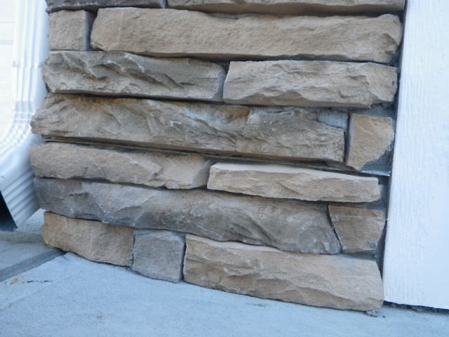

Mark P Posted March 8, 2015 Report Share Posted March 8, 2015 Thanks Kurt. This blog has some good graphics of how AMSV should be constructed. http://jnxclusives.blogspot.com/ From what I can tell, I don't see that the house I looked at yesterday has the weep screed. Link to comment Share on other sites More sharing options...
palmettoinspect Posted March 8, 2015 Report Share Posted March 8, 2015 This is what the typical weep screed looks like on stone veneer around here. Some of the contractors add the additional stone to the slab under the weep screed some don't. Click to Enlarge 52.61 KB Link to comment Share on other sites More sharing options...
kurt Posted March 8, 2015 Report Share Posted March 8, 2015 Thanks Kurt. This blog has some good graphics of how AMSV should be constructed. http://jnxclusives.blogspot.com/ From what I can tell, I don't see that the house I looked at yesterday has the weep screed. Probably not. Hardly any do. Link to comment Share on other sites More sharing options...
