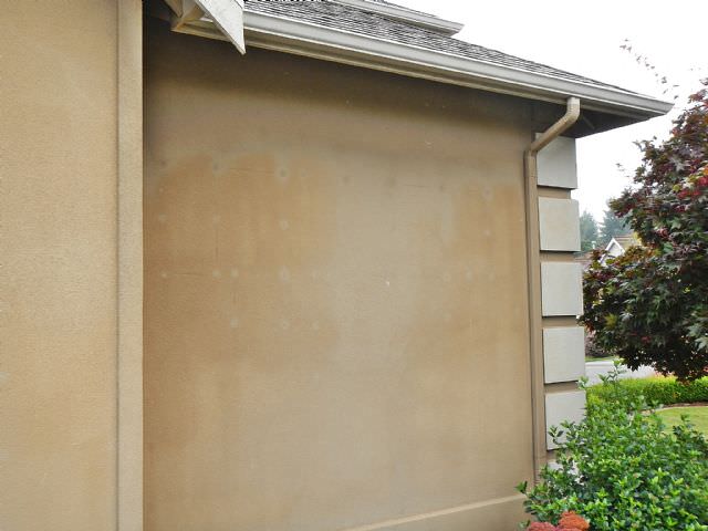

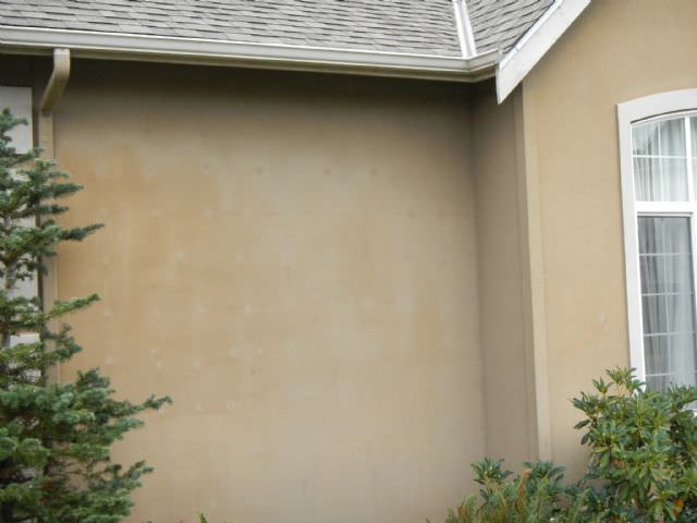

Robert Jones Posted October 8, 2014 Report Share Posted October 8, 2014 This is a home built in 1999. One side of the EIFS looked faded etc... Is it a lack of paint/coating? I was under the impression that this stuff rarely, if ever needs "repainting". Click to Enlarge 45.56 KB Click to Enlarge 38.13 KB Click to Enlarge 29.7 KB Link to comment Share on other sites More sharing options...

caryseidner Posted October 8, 2014 Report Share Posted October 8, 2014 Robert, it looks like the fasteners are transmitting through. If so, my first thought would be a moisture problem. Link to comment Share on other sites More sharing options...
kurt Posted October 8, 2014 Report Share Posted October 8, 2014 Same here. Which is always a pretty safe bet. Every time I've had the chance to open one up, there's always water stains or worse. Link to comment Share on other sites More sharing options...

Scottpat Posted October 8, 2014 Report Share Posted October 8, 2014 Folks improperly paint EIFS all the time, once it is painted you need to keep painting. I doubt that wall has a moisture problem, normally walls without rooflines intersecting or penetrations in it will not have moisture problems. The fasteners are showing most likely from being driven too far into the foam board and then the base coat coat is thicker over the fasteners, or it could be the lack of a base coat and or the finish or lamina coat was applied too thin. Add a little sunlight, age and pressure washing and you have what we are seeing.... Link to comment Share on other sites More sharing options...
Bryan Posted October 8, 2014 Report Share Posted October 8, 2014 If you look at the joints between foam pieces, they have not been properly offset. It also looks like they used the one fastener in the seam technique, which if memory serves correct, is not allowed. Link to comment Share on other sites More sharing options...
Marc Posted October 8, 2014 Report Share Posted October 8, 2014 I'm with Scott and Bryan; panels not staggered as they should have, base coat too thin or missing and finish coat too thin. Common denominator is the EIFS installer. He screwed it all up. Marc Link to comment Share on other sites More sharing options...

StevenT Posted October 9, 2014 Report Share Posted October 9, 2014 I agree with Scott about the improper preparation of the fasteners. They could have been set too deep and or the basecoat was improperly applied. Maybe they tried to apply the basecoat and cover the fasteners in one coat. I also see improperly painted EIFS quite often. When painting EIFS it should be properly prepared and elastomeric paint should be used. Link to comment Share on other sites More sharing options...
