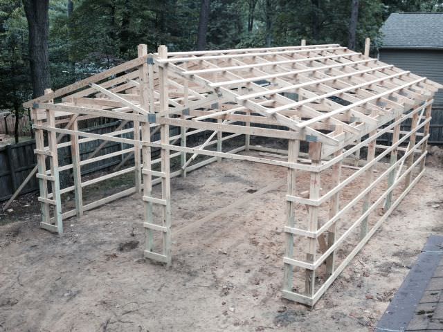

John Dirks Jr Posted October 3, 2014 Author Report Posted October 3, 2014 Framing partially completed Click to Enlarge 84.96 KB Front view. The right post look crooked in this picture for some reason. But trust me, everything is square and plumb. Click to Enlarge 133.9 KB Side view Click to Enlarge 82.34 KB

John Dirks Jr Posted October 28, 2014 Author Report Posted October 28, 2014 What are your headers bearing on? Roof loads carried as follows; 10 trusses total 4' on center including the gable trusses. The four trusses at inner post positions are bearing directly on the 6x6 laminated Tuff Post which are notched at the top for the bearing spot. Click to Enlarge 39.86 KB Click to Enlarge 51.56 KB The gable trusses are bearing on the headers which over hang the corner posts. The end gaps are filled with 2x6 and nailed in with 16d to extend the bearing surface for the gable trusses. Click to Enlarge 34.84 KB The remaining 4 trusses are bearing on the headers and are fastened with 2x6 pieces which are sandwiched between the header gaps. Click to Enlarge 45.32 KB Click to Enlarge 54.19 KB The headers fastened to the posts with 16d and structural ledger screws. Click to Enlarge 34.98 KB Click to Enlarge 48.19 KB Click to Enlarge 29 KB Two 2x12 stacked as header for vehicle door openings and nailed with 16d including 2x6 nailed to post for additional header bearing. I think the double stacked 2x12's will do good in preventing wind from racking the building. Click to Enlarge 33.28 KB
John Dirks Jr Posted October 28, 2014 Author Report Posted October 28, 2014 Nails. Ain't got any weight on them anyway. I guess John doesn't get termites in his part of the country. No one here has built a shop on dirt in over half a century. Marc We have Eastern Subterranean here. Unlike you which also have the much more voracious Formosan. The Tuff Posts have lifetime warranty for the original owner but I'll get my pest control friend to do preventative treatment anyway. http://www.tuff-post.com/
Tom Raymond Posted October 28, 2014 Report Posted October 28, 2014 The stacked headers will be much appreciated by the overhead door installer.
