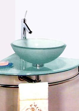

Richard Moore Posted November 10, 2005 Report Share Posted November 10, 2005 Kurt, If it's not legal, then there's an awful lot of high-end kitchen and bath stores breaking the law. Download Attachment: nooverflow.jpg 18.38 KB As for stupid...how many people overflow their kitchen sinks? No overflows there either. In a lot of cases the small overflows in vanity sinks wouldn't keep up with fully open faucets anyway. Stupid is walking away from any sink with the faucet open and the stopper closed, overflow or not, and you just can't legislate that. Link to comment Share on other sites More sharing options...

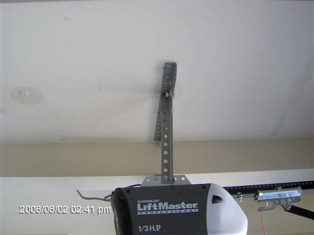

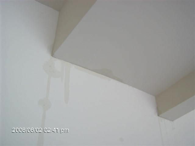

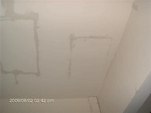

Bob White Posted May 4, 2007 Report Share Posted May 4, 2007 I always check them. The photos below are from a 11 month old home, All four tub overflows were still blocked. Download Attachment: garagewater3.jpg 26.92 KB Download Attachment: garagewater4.jpg 27.99 KB Download Attachment: garagewater.jpg 38.06 KB I usually fill all sinks and tubs to the overflow, and a little before I go into the basement or crawl, I go around the house and pull all the plugs at once. If there are leaks, I can usually find them. Link to comment Share on other sites More sharing options...
