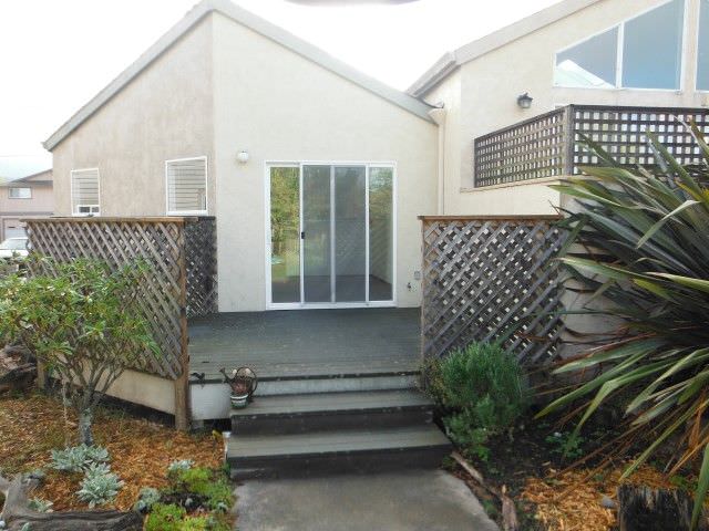

Denray Posted September 30, 2014 Report Share Posted September 30, 2014 Do these white streaks coming off the corners of the windows mean anything special. I know its a poor seal to have stucco-caulk-window with no casing bead. Click to Enlarge 49.84 KB Link to comment Share on other sites More sharing options...
Marc Posted September 30, 2014 Report Share Posted September 30, 2014 Not that I know of. They're immediately below the drain openings on the window frame, looks like. Marc Link to comment Share on other sites More sharing options...

John Kogel Posted October 1, 2014 Report Share Posted October 1, 2014 The stucco is dirty except where it has been washed by seepage from around the windows. (I think) Is there a busy road or highway close by? I've seen soot like that where it was coming from diesel engines and maybe brake pads. Link to comment Share on other sites More sharing options...
