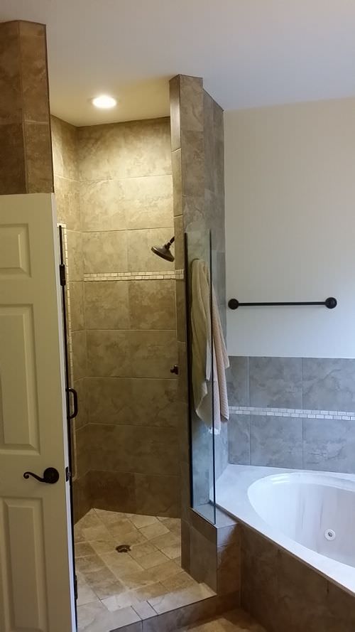

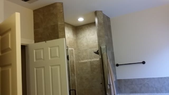

phases Posted September 18, 2014 Report Share Posted September 18, 2014 Hi all! Well, I'm here naturally, with a question. Long story short - our bathroom is too humid, so I took the 15 year old fan out and put in a new one. - old was in toilet area (you can sorta see the door into it on left side of pic of new fan. It was 50 cfm, and the vent ductwork was pointing the wrong way and so made a 180 to go out of the house (over shower), and it was confined in that room. - So, I took that out, came outside of the room, got a 140 cfm, mounted it the correct orientation. So now it is not in the room, and probably 6ft less duct travel time with no bends. But here is my concern, now that I have it up and the dry wall started, of course. Is it a problem that it is right above the door out of the bathroom? Will it just pull fresh air from there and blow that out and not actually vent the steam/moisture from the bathroom?? I can move it one or two joists toward the middle of the bath but .. well, frankly I'm in deeper than I want to be already LOL. (I've never done drywall). Then it would also have at least one possibly two bends in the ductwork going out and be longer again. So. 1) above door, but out of bathroom at least, 10ft or so run to side of house, no bends, start repair. Or, 2) lots of work to move a joist or two, add 4 or five feet of duct, 1 or two bends, lots more repair. I do think 2 would be "better" in a perfect world, but is it fine enough as is (without the added loss of CFM due to the bends) to justify skipping all the work? Will the steam rise above the cool air of the other room anyway so, no worries? (also note, there is a second sink to the right of the one you can see, across from the toilet room section, and the air supply register is directly below the new location for exhaust, on the floor in doorway coming in) Help! And, thanks Click to Enlarge 22.91 KB Click to Enlarge 46.2 KB Click to Enlarge 37.74 KB Click to Enlarge 20.21 KB Link to comment Share on other sites More sharing options...
John Kogel Posted September 19, 2014 Report Share Posted September 19, 2014 Most people should close the bathroom door when they shower. [] So the fan will work fine when needed most. Install a digital timer switch on it, hit 20 mins and leave the door partly closed when you head out. I think it will be fine as is. Code toadys might protest that you need a fan in the toilet enclosure as well, separate room. Moisture is not an issue in there, so that is more a lifestyles issue. If someone raises the issue of venting the crapper room, cut the door off top and bottom like a public washroom. Or take the door off. Link to comment Share on other sites More sharing options...
Marc Posted September 19, 2014 Report Share Posted September 19, 2014 Moisture laden air is lighter than dry air and rises to the top of the room. Since that's where the fan is, that arrangement works pretty good. Try to see the effect of the fan as lowering the pressure throughout the room. The incoming air will come from wherever it can. If you leave the door open then most of it will certainly come from there. If it's close, it'll come from the gaps around the door, the register, and from any cracks or openings in the room. It's got to come from somewhere or the fan won't be moving any air in the first place. Make sense? Marc Link to comment Share on other sites More sharing options...
phases Posted September 19, 2014 Author Report Share Posted September 19, 2014 Thanks for the replies guys. Yes it does make sense, I'm just hoping to not have the effect of air coming straight through the top of the door way and straight up into the fan, thus leaving all the rest of the bathroom stagnant. I've got conflicting thoughts on open vs shutting the bathroom door. If it wants to move 140 cfm, wouldn't I chock the fan by closing the door, thus turn it into a 70 cfm, effectively? Though, between the door cracks and the floor register I would think it would come close. Perhaps cracking the door is the best compromise. I have to count on turbulence, and/or moisture/humidity rising above cooler air, to feel comfortable with it, I think. Warm air rises so, Yeah I think the cool from the doorway would/should just kinda go under the warm air and keep the flow working well. (Especially with the two foot of wall above the door to hold the warm air) Link to comment Share on other sites More sharing options...

David Meiland Posted September 19, 2014 Report Share Posted September 19, 2014 Your last 50CFM fan might have been moving 20CFM with a lousy duct run. If you now have a 140 and a decent duct, it should make a huge difference. I don't see an issue with your placement in the ceiling. This guy makes good videos and is entertaining Link to comment Share on other sites More sharing options...
phases Posted September 19, 2014 Author Report Share Posted September 19, 2014 You know, the supply register's ductwork is no smaller than the vents so, Between that and the near inch gap under the door, I don't think I'm too worried about having the door shut and really reducing efficiency or harming the fan. Two showers since install, have fared real well. It really seems to move the air! The room itself is just higher humid than the rest of the house and I don't know what much more I can do about that. I accidentally left it running 3 hours this morning, it was still mid 60s Rh. Still wet in the shower (that will be wet non stop unless I can sort out some circulation in there). So, I think the fan itself, its placement, etc, I'm happy with. (and it's of course so much quieter!) If I want to improve further I'll have to take other measures. Thanks again all! Link to comment Share on other sites More sharing options...
