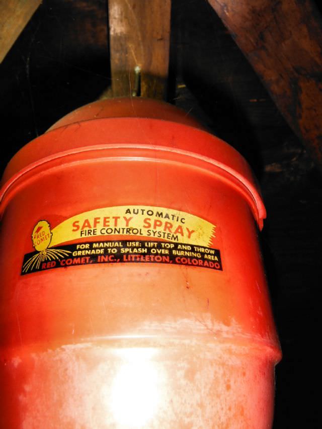

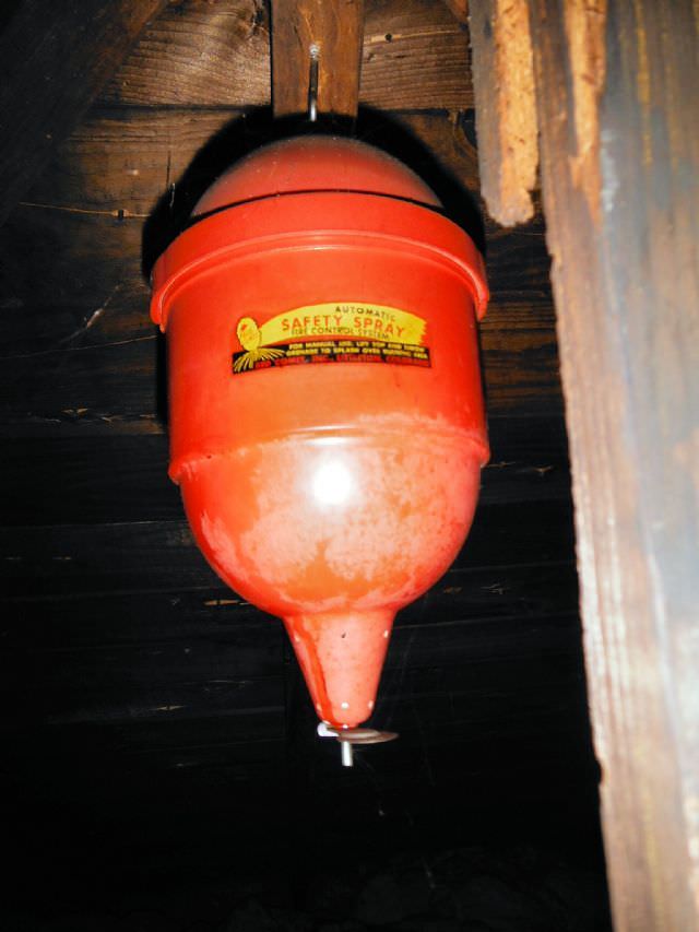

Mike Lamb Posted September 12, 2014 Report Posted September 12, 2014 Red Comet is still in business. You can buy this 1950's? automatic fire control on eBay for about $40. Click to Enlarge 60.47 KB Click to Enlarge 63.29 KB The company also used to make these grenades for fire control which was a glass ball filled with some kind of fire extinguishing liquid that you could whip at a fire.
Bill Kibbel Posted September 12, 2014 Report Posted September 12, 2014 The company also used to make these grenades for fire control which was a glass ball filled with some kind of fire extinguishing liquid that you could whip at a fire. It's the same thing. That's just a metal canister with the glass fire-suppression grenade inside. You have to open the cap and read the label on the glass to reveal if it contains carbon tetrachloride or CM7. http://www.oldhouseweb.com/how-to-advic ... zard.shtml
aschauer82 Posted September 13, 2014 Report Posted September 13, 2014 The company also used to make these grenades for fire control which was a glass ball filled with some kind of fire extinguishing liquid that you could whip at a fire. It's the same thing. That's just a metal canister with the glass fire-suppression grenade inside. You have to open the cap and read the label on the glass to reveal if it contains carbon tetrachloride or CM7. http://www.oldhouseweb.com/how-to-advic ... zard.shtml I kinda like that the direction says through grenade. My fire extinguisher sucks by comparison.
