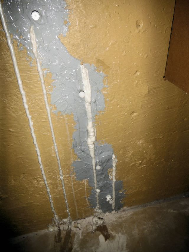

Mike Lamb Posted September 5, 2014 Report Posted September 5, 2014 The paste-over has failed at many places on this foundation injection causing the polyurethane to leak. One. How critical is this to the waterproofing process? Two. How do you correct this once everything has cured? Click to Enlarge 83.85 KB
kurt Posted September 6, 2014 Report Posted September 6, 2014 Are you sure this isn't foaming epoxy? Is the ooze sticky, wet, or is it soft?
Mike Lamb Posted September 6, 2014 Author Report Posted September 6, 2014 Looks and felt like expandable poly. I have done a couple Dap Crack-Pak injections with similar stuff but not so sloppy.
kurt Posted September 6, 2014 Report Posted September 6, 2014 Yeah, I don't like that stuff; I like the foaming epoxy. My experience with PF is all failures are applicator error. If it's oozing, someone messed up.
mjr6550 Posted September 8, 2014 Report Posted September 8, 2014 It looks like they do not properly seal the surface before injecting with polyurethane. That is not a large amount of leakage, so it may be no big deal. The important thing with injection is to go back and reinject each port after moving up to the next port or two. Only time will tell whether there will be leakage at the crack. Generally polyurethane is better than epoxy for non-structural crack repair, especially is the house is less than about 2 year old.
Mike Lamb Posted September 8, 2014 Author Report Posted September 8, 2014 It looks like they do not properly seal the surface before injecting with polyurethane. That is not a large amount of leakage, so it may be no big deal. The important thing with injection is to go back and reinject each port after moving up to the next port or two. Only time will tell whether there will be leakage at the crack. Generally polyurethane is better than epoxy for non-structural crack repair, especially is the house is less than about 2 year old. I have seen many injections and have done some myself. I would call that a lot of leakage and why the less than 2 year observation?
mjr6550 Posted September 9, 2014 Report Posted September 9, 2014 When epoxy injection is performed before the foundation has fully cured additional cracks often develop due to the additional shrinkage. After about 2 years additional shrinkage from curing should not occur. Yes, it is more leakage than typical, but considering how much polyurethane expands it does not amount to a large amount of material. As I stated, it is more important whether they reinjected the holes. If the cracks were very small it is possibly that the improper surface sealing prevented the installer from applying enough pressure to fully inject the cracks. That is where time will tell.
