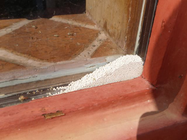

JPLomeo Posted September 1, 2014 Report Share Posted September 1, 2014 Just saw this yesterday inside a large dual pane window with failed seals in a rural area of AZ. Home was built in 83'. I have never seen anything like it in 23 years of inspecting homes. My guess is some type of insect eggs? If anyone has any thoughts it would be greatly appreciated. Happy holiday! Jp[?] Click to Enlarge 44.47 KB Link to comment Share on other sites More sharing options...
Brandon Whitmore Posted September 1, 2014 Report Share Posted September 1, 2014 Dessicant beads--they are what absorb the moisture between the panes of glass. Link to comment Share on other sites More sharing options...
Jim Katen Posted September 1, 2014 Report Share Posted September 1, 2014 Dessicant beads--they are what absorb the moisture between the panes of glass. Indeed. They're usually inside the hollow aluminum spacer bars. Those must have fallen out through a gap or split seam. Link to comment Share on other sites More sharing options...
