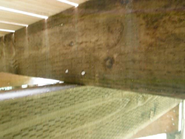

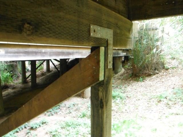

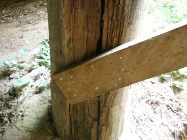

Owners got pest report prior to putting on market. Hired out deck repairs and here's what we got.

There is a rim joist behind that siding. Just toe nailed on that outer beam. Pile of nails at that strut. Just nails holding it against the house. could be pretty lose a couple of years from now.
