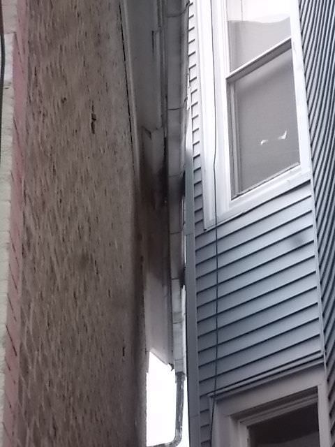

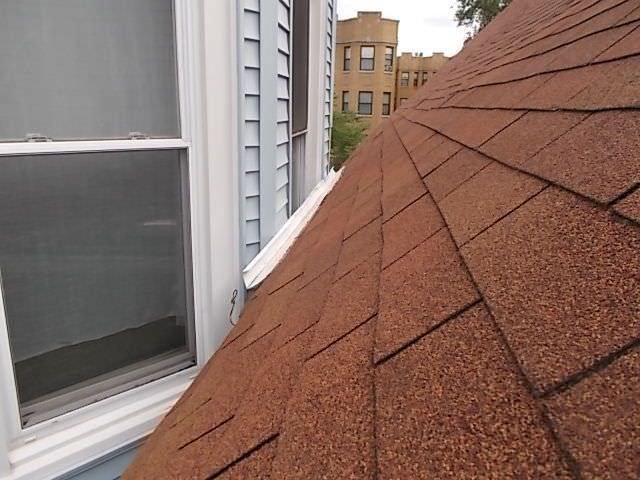

Any thoughts as to how to prevent roof water from draining into the neighbor's window? I am thinking that removing the soffit in this area is the only viable choice.

I was thinking the vinyl siding house was built against that roof edge, so it would be their problem. But how did they get fastenrs into the siding?
And what were the roofers thinking? Not our problem? [:)]
Posted
Brick house is 1906 and the frame home maybe 20 yrs later. Since the frame home isn't going to move I think removing the soffit in the middle should create about 10-12" of space. Blocking the roof with a alum. curb isn't the answer.

Simon's got it. Moronic Chicago stuff.
I've seen dozens of silly stuff like this, flowing into windows, walls, vent shafts, or whatever. The average Chicago property survey is chock full of transgressions, overhangs, all manner of building parts hanging over other properties, and general idiocy that all gets buried under the banner and approval of Chicago Title.
Most people put a deflector in under a course of shingles and shunt it over to one side or the other.
Posted
Maybe a V-shaped deflector would work instead of the flat one that they are trying to do.
"What about just taking the gutter off?"
This house has a stone foundation with plenty of dampness and seepage. Gutters will go a long way in keeping the place a little dryer.
Probably. A well designed V-shaped deflector would probably work. Still extra stupid, but it would be better than the beer can technology they're currently employing.

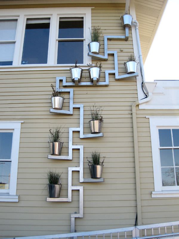

Hockstein's planter isn't a bad idea either. [:-eyebrow
As much as I hate gutters and they're attendant foolishness and maintenance concerns, one pretty much has to have them in the City.
I read in the Trib the "average" Chicago house collects somewhere around 127,000 gallons of water every year; not sure if that's the exact number, but it was somewhere well north of 100,000 gallons per year. That's a lot of water to be dumping next to an old stone foundation. Better to collect it and send it somewhere other than the basement.

Gutter won't fit. The eave is smack up against the other house. Diverters and a gutter might work. Honestly, those things are usually such piles of confusion, getting close might be close enough.

Mike suggests cutting the eave back and I concur, or do I concurr?

Every time I look at this, I think about what this must look like during the winter.
Ice and water from the upper roof,(hip?)to the lower, with a gutter to help back it up into a huge ice sculpture.
I mean no harm to the new guy, but, c'mon. Take a look at what's there and consider a few things before tossing some lame ass, perfect world advice that's useless to this condition.
Both of those places are still standing after 100 years + of Lake Michigan winters. If it ain't broke, don't fix it.
