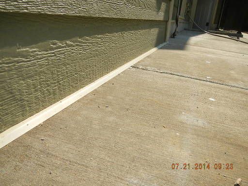

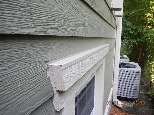

kurt Posted July 22, 2014 Report Posted July 22, 2014 I literally never see this stuff, until today. Bunch of pics showing stuff that can't be right. I couldn't find a link at the LP site, so any opinions welcome. Window sills all back pitch to the house. Click to Enlarge 49.79 KB Siding smashed down onto flashing and sidewalk. Click to Enlarge 44.42 KB I could go on with a dozen different conditions like these; contact with sidewalks, no flashing, lots of caulk, sills don't drain, and the sorts of stuff Hardibacker can't handle so I don't think this stuff will. Anyone got a link for LP installation spec's.?

Jim Baird Posted July 22, 2014 Report Posted July 22, 2014 ...never saw anyone use it for a casing headpiece, though I saw a whole lot of cute little horizontal header wood pieces held up with something like molded casing, which almost all tilted wrong way...clueless builders asked, "How do I fix it?".
