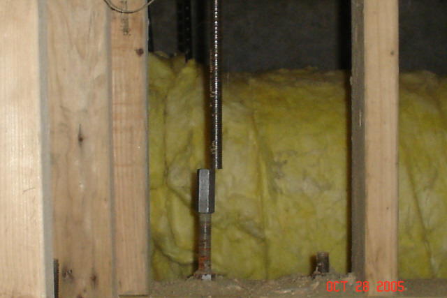

CHI2 Posted October 31, 2005 Report Posted October 31, 2005 Found this on a new home. I don't inspect many new ones so this has me baffled. The threaded rod from the subfloor misses the rod and coupling from the foundation by a good margin. There is an identical set up about 4' to the right of this one that does line up. This is not on an exterior wall but in the midst of the crawl space. Any thoughts? Thanks, Rob Download Attachment: Threaded Rod.JPG 128.41 KB
CHI2 Posted October 31, 2005 Author Report Posted October 31, 2005 The picture is taken straight on. The rod from the top completely misses the one at the bottom. Regardless, they apparently should have lined up, but what are their use?
