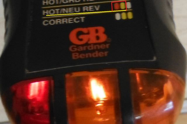

Denray Posted May 7, 2014 Report Share Posted May 7, 2014 How do you tell if open ground when the lights show hot/neutral reverse. Open ground would just have the middle yeller light on. Click to Enlarge 30.93 KB Link to comment Share on other sites More sharing options...
John Kogel Posted May 7, 2014 Report Share Posted May 7, 2014 Try that one agin, Denny? No comprende. [] Only the center light on tells you there is no ground. If you plug the cheezy 3-light tester into a 2-prong adapter, only the center light will light, no matter which way you plug it into a receptacle. So it can't tell you if hot and neutral are reversed on an ungrounded outlet. That is not what you asked, tho. To find reversed polarity on a polarized but ungrounded receptacle, hold your finger over the narrow slot and bring you voltage sniffer in to the wide slot. It will not ring, then ring when you remove you finger. Thanks Trent for enlightening me on that one. Link to comment Share on other sites More sharing options...
Denray Posted May 8, 2014 Author Report Share Posted May 8, 2014 It's a three pronger and it's showing reverse polarity. But what if it had an open ground too. The reverse thing uses that center light, but so does an open ground. Perhaps it has an open ground and reverse polarity. How would you be able to tell that? Link to comment Share on other sites More sharing options...

Marc Posted May 8, 2014 Report Share Posted May 8, 2014 How do you tell if open ground when the lights show hot/neutral reverse. Open ground would just have the middle yeller light on. Click to Enlarge 30.93 KB As I understand the lamp characteristics, the left lamp would illuminate brightly and the other two only dimly (because they're in series with each other). Download Attachment: Receptacle_tester_wiring_diagram.pdf 33.68?KB Marc Link to comment Share on other sites More sharing options...

Jim Katen Posted May 8, 2014 Report Share Posted May 8, 2014 How do you tell if open ground when the lights show hot/neutral reverse. Open ground would just have the middle yeller light on. Click to Enlarge 30.93 KB You don't. Three light testers are ok as a quick go/no go look at a receptacle. They are completely useless if there is more than one defect in the receptacle wiring. They cannot detect multiple defects. BTW, I've found the Suretest to be very unreliable at detecting bootleg grounds. Link to comment Share on other sites More sharing options...

rkenney Posted May 9, 2014 Report Share Posted May 9, 2014 How do you tell if open ground when the lights show hot/neutral reverse. Open ground would just have the middle yeller light on. Click to Enlarge 30.93 KB John Kogel's diagram is most common wiring for those testers. If there is an open ground only the center light will light regardless of the polarity of the other terminals. At that point reversed polarity doesn't even matter the circuit needs repair. (so, if you show reversed polarity, you can't have an 'open' ground) John's technique with the 'sniffer' works and will indicate reversed polarity if you want to go to that much trouble. The sure test lights are driven by a microprocessor so there is a lot more flexibility in lighting possibilities. No ground is indicated by lighting all three neon lamps. A little thought here and you realize what can you do to that display and indicate - open ground, and some other problem? fortunately the display also indicates a ground problem with one of the additional functions. There are only eight display possibilities with three light testers, cheapo or Sure Test, after that you need further investigation. Link to comment Share on other sites More sharing options...
