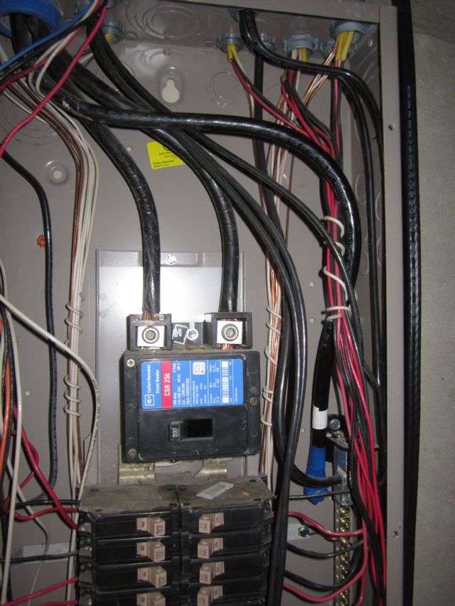

asihi Posted April 25, 2014 Report Share Posted April 25, 2014 I had a job the other day on a 10 year old building. Everything was fairly typical until I got to the panel. I removed the cover and found that the service neutral cable was loose and hanging in the panel. The end of it was taped and it looked like it was like this since day one. This was the typical set up that we see all the time; a lateral service to the meter with rigid metal conduit from the meter cabinet to the panel with 3-cables. The service was grounded with a driven rod and a connection to a water line in the building and was bonded. I'm aware of all the implications with this set up, but in my head, I'm trying to figure out exactly how the electrical system was functioning. Was it the ground connection to the water line? Because of the bond in the panel? Thanks for your help. Tony Click to Enlarge 96.22 KB Link to comment Share on other sites More sharing options...

John Kogel Posted April 26, 2014 Report Share Posted April 26, 2014 If the neutral is bonded to the meter box, it should be, then the metal conduit is carrying neutral current from the breaker panel to the meter box. So it works but it is very wrong. Link to comment Share on other sites More sharing options...
Jim Katen Posted April 26, 2014 Report Share Posted April 26, 2014 Do you have a photo of the entire box? Link to comment Share on other sites More sharing options...
asihi Posted April 26, 2014 Author Report Share Posted April 26, 2014 Do you have a photo of the entire box? I don't. It was in a relatively small room and I couldn't get a wide enough shot. My initial thought was like John stated; the panel was bonded and the current making its way back to the service neutral by the bond in the meter cabinet. I can't believe this went unnoticed for so long. Someone finished the basement of this building and added some circuits. I had to stare at this for a couple minutes to make sure I wasn't going crazy. Link to comment Share on other sites More sharing options...
