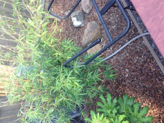

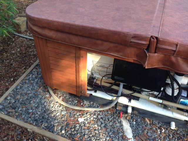

* It is about 7' from the panel to the closest point on the spa.
* There is no walkway between the panel and spa.
* It is just laying on the ground, any bends are coincidental besides 90' going up into box on both ends.
* It is LFNC-B
* while it is outside, I don't believe there is anything that could cut or otherwise damage it. The stairs usually cover most of it - then it is under foliage.
I put up a couple pictures in case this helps.

Well, I can see the electrician's concern. It's definitely subject to damage there. You can't just string this stuff along the ground for 7 feet as if it were a garden hose. In addition, this conduit is supposed to be securely fastened at least every 3 feet and within 12 inches of the wiring box and the spa.
I'd suggest buried schedule 80 PVC conduit in this location.
