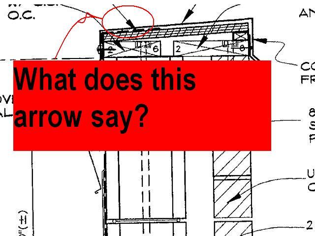

Konrad Posted October 21, 2005 Author Report Share Posted October 21, 2005 Marc, Not sure I totally follow your question, so here's a scan of the parapet wall detail. We don't get so specific as to call out mechanical fastener spacings on the flashing. That's a "manufacturer's recommendation" type thing. Sorry the file size is so large. The elevation of the flashing is not quite the same, because this scan is from a different (but similar) store. Link to comment Share on other sites More sharing options...
mcramer Posted October 22, 2005 Report Share Posted October 22, 2005 Originally posted by Konrad Marc, Not sure I totally follow your question, so here's a scan of the parapet wall detail. We don't get so specific as to call out mechanical fastener spacings on the flashing. That's a "manufacturer's recommendation" type thing. I've seen them slip down the wall if they're not fastened to the wall. The coping might hold it in place. Actually, in my neck of the woods, it would be a code thing, as the code says you shall install roof coverings in compliance with the manufacturer's specifications. Link to comment Share on other sites More sharing options...
Jim Katen Posted October 23, 2005 Report Share Posted October 23, 2005 Originally posted by Konrad . . . so here's a scan of the parapet wall detail . . . The top of the detail is cropped out. What does the arrow at top say? - Jim Katen Download Attachment: Parp Wall Detail.jpg 52.08 KB Link to comment Share on other sites More sharing options...
Konrad Posted October 24, 2005 Author Report Share Posted October 24, 2005 That note says: 3/4" exterior ply with blocking as required to provide slope. Link to comment Share on other sites More sharing options...
