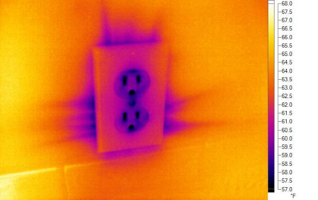

David Meiland Posted January 31, 2014 Author Report Share Posted January 31, 2014 Hmmmm... those gaskets are uniformly regarded by energy auditors to provide little air-sealing. Here's an image of a receptacle that has a foam gasket behind it. This is during a blower door test in cold weather. You can see air leaking in and cooling the drywall, and cold air has also cooled the receptacle itself (because it has air pathways through it), but the trim plate is warmer (and nicely uniform) because it's insulated. In spite of that, I put them in my house. They were giving away handfuls of them at the county fair, so I got a bunch. We may end up sealing between the drywall and the box, and putting kid protectors in the unused outlets. Click to Enlarge 32.8 KB Link to comment Share on other sites More sharing options...

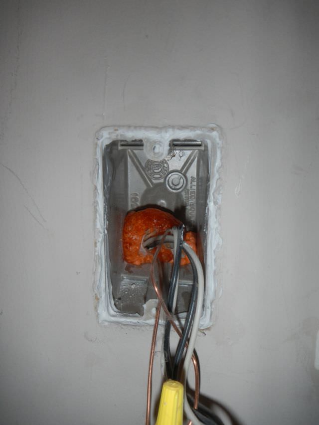

Ben H Posted January 31, 2014 Report Share Posted January 31, 2014 If you really want to seal them: Caulk the box to the drywall, it sometimes takes a couple spins depending on how bad the cutout is. Kill the juice and hit the wire penetration with fire-stop foam. I have one of the pro guns that can leave the can on for long periods of time without drying up. Whenever I paint a new room, I always seal up the outlets and switches. If done correctly this will seal them 100%. Here is a shot from one I did back in November. Click to Enlarge 43.87 KB Link to comment Share on other sites More sharing options...
