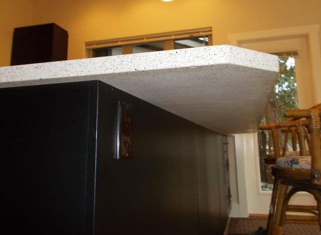

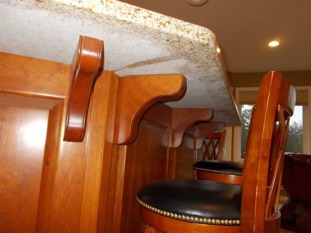

John Kogel Posted January 30, 2014 Report Posted January 30, 2014 They don't always get it right. More brackets are better than less, or none. Click to Enlarge 47.86 KB Click to Enlarge 31.26 KB

Bill Kibbel Posted January 31, 2014 Report Posted January 31, 2014 I've uploaded the MIA Residential Stone Countertop Installation Guidelines to the file library. I've used this as a defensible standard. https://inspectorsjournal.com/forum/Lin ... +%26+baths The spacing of the brackets in the OP installation need to be no more than 36" apart. Cabinet guy needs to install 2 more brackets.
