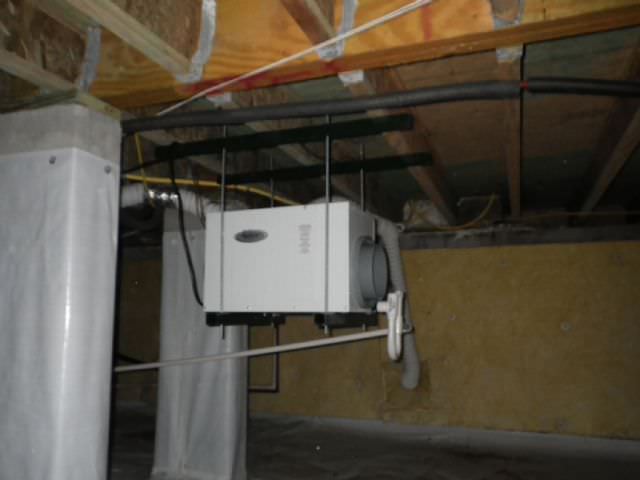

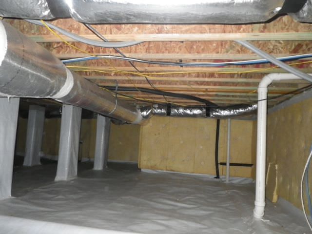

Posted
Kurt has nailed it. There's a moisture problem causing the growth on the floor. Ground moisture, coupled with the moisture intrusion, AC inside the home, and the outside humid air used to ventilate the crawlspace causes the perfect environment for the growth. Your floor insulation is not helping either.
Very common issue for the Southeast. That looks to be like almost every floor system here in Charleston about 2 hours away from you.
From the pictures it's not terrible, but a vapor barrier alone will not stop it. Sealing off the vents from the outside air, condition the existing air with a dehumidifier and correcting the one spot of moisture intrusion that you noted is best.
Here's a few pictures of what a really nice crawlspace looks like after. This home was done from day one and shows no sign of growth. The downstairs air handler is located in the crawlspace and does not sweat either. Most people do not insulate the walls after removing the floor insulation, but it's an option.
Click to Enlarge
48.67 KB
Click to Enlarge
34.39 KB
Click to Enlarge
31.28 KB

Posted
The pic Kiel posted is a beautifully finished crawl. Running the VB up the piers (moisture migrates through concrete like a sponge), no joist cavity insulation, perimeter finished with insulation panels, conditioned, done.
Joist cavity insulation does very little to effect heating; it's another of those ingrained habits, aided by building codes that have just about everything related to insulation and ventilation wrong.
Removing the joist cavity insulation and insulating the perimeter of the area allows capturing all that lovely free geothermal heat emanating from your crawlspace floor. I'm betting the crawlspace would be warmer, not cooler, by taking Kiel's recommendations.
As an example, my >90 year old bungalow had 1st fl. platform joist cavity insulation, and nothing in the basement perimeter; in winter, you could sometimes see your breath down there. I ripped out all the joist cavity insulation, insulated the perimeter with 2"XPS foam (the pink or blue stuff) from the basement floor to the 1st fl. platform subfloor, then installed a thermal barrier of 5/8" drywall over the foam.
The basement went from being freezing to the warmest and nicest room in the house on a cold winter day.
Do it like Kiel's pics, you won't be sorry.
