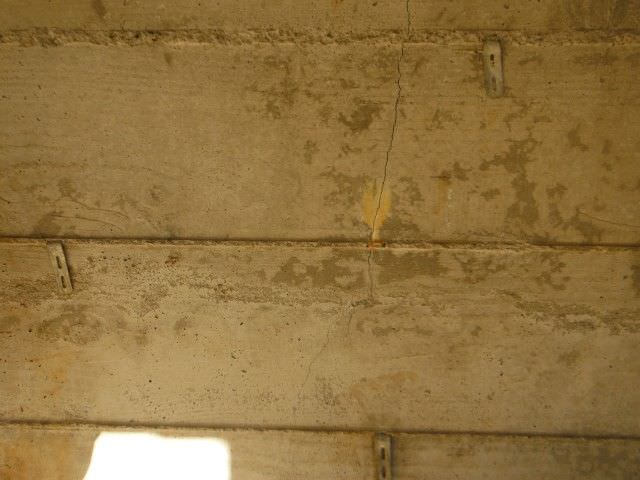

Every 5 ft or so on this foundation which is perpendicular to the hill side has a crack like this that is wider at the top. There are about 4 total. Is it a problem? No displacement.

Unless there's more to it than that, no. Just mention it so the client will know you didn't miss it. Cracks in foundations makes a lot of uninformed folks jump.
