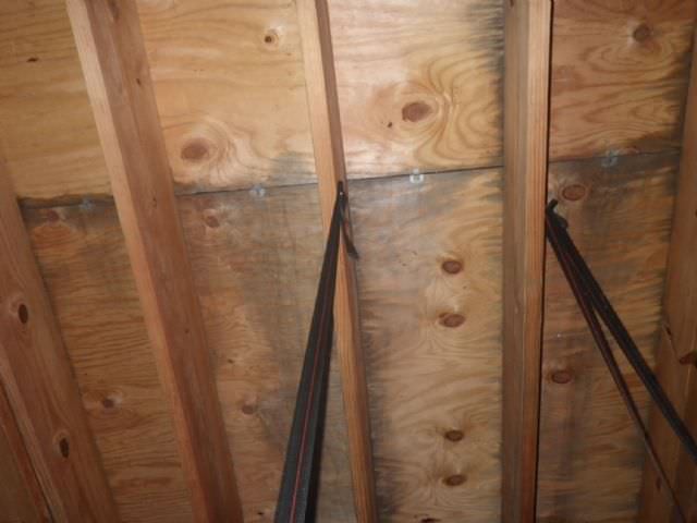

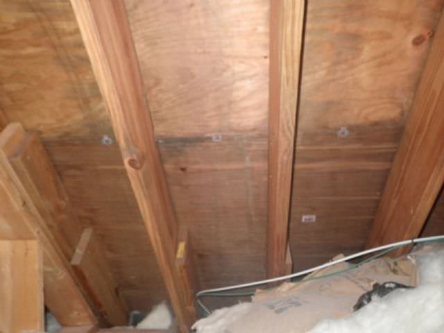

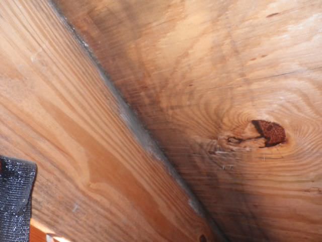

palmettoinspect Posted October 31, 2013 Report Share Posted October 31, 2013 Guys, I'm unsure as to what exactly is causing this staining to the roof sheathing. There's black stains throughout the roof sheathing worst at the rafter edges and sheathing seams. Home is 2007 with the original standing seam metal roof with a secondary peel and stick underlayment visible between the sheathing. Metal looks great with no signs of abnormal wear. My concern is the underlayment oozing from excessive heat generated by the metal roof and that's what's causing the staining. I understand this can happen, but have never seen it myself. I was also informed that the attic fans were not connected for the first few years of the roofs life, and worry about condensation issue in the attic during the humid summer months. There's some very minor fungi growth visible in picture #3 to the roof sheathing. No drips stains noted under ductwork etc. All areas tested were dry at the time of my inspection. Or, is it obviously staining from rain water maybe during a delay in the construction process? Thoughts? Thanks, Kiel Click to Enlarge 37.27 KB Click to Enlarge 38.73 KB Click to Enlarge 41.18 KB Click to Enlarge 33.79 KB Link to comment Share on other sites More sharing options...
Marc Posted October 31, 2013 Report Share Posted October 31, 2013 Construction era damage resulting from a rainstorm that occurred after the sheathing was installed but before the secondary rainwater protection...fits pretty good. Marc Link to comment Share on other sites More sharing options...
palmettoinspect Posted October 31, 2013 Author Report Share Posted October 31, 2013 Construction era damage resulting from a rainstorm that occurred after the sheathing was installed but before the secondary rainwater protection...fits pretty good. Marc It does. Maybe I'm overthinking again! Link to comment Share on other sites More sharing options...
John Kogel Posted November 1, 2013 Report Share Posted November 1, 2013 Construction era damage resulting from a rainstorm that occurred after the sheathing was installed but before the secondary rainwater protection...fits pretty good. Marc It does. Maybe I'm overthinking again! I'm with Marc on this one. The plywood got rained on before the roofers arrived, a non-issue. Link to comment Share on other sites More sharing options...

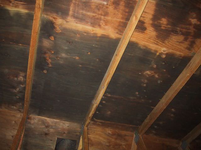

Jim Katen Posted November 1, 2013 Report Share Posted November 1, 2013 Thanks guys. That makes feel me a little better. Hausdok, How bad do the underside roofs look around there? This is a rarity in this particular neighborhood. Most sheathing still looks great even after a few roofs. Click to Enlarge 42.71 KB Link to comment Share on other sites More sharing options...
hausdok Posted November 1, 2013 Report Share Posted November 1, 2013 Thanks guys. That makes feel me a little better. Hausdok, How bad do the underside roofs look around there? This is a rarity in this particular neighborhood. Most sheathing still looks great even after a few roofs. Jim's photo is one of the more extreme examples but I see something like that, and some that are somewhat less so, pretty frequently around here. Fungi grows on everything around here. That's why I go so friggin' ballistic when I hear folks moaning about "toxic" mold and displaying pictures of a little mildew fungi in a shower. OT - OF!!! M. Link to comment Share on other sites More sharing options...
Jim Baird Posted November 1, 2013 Report Share Posted November 1, 2013 I saw sheathing like that under a roof where steel panel was slapped on top of a cpl of layers of three-tab, no vents at all. Link to comment Share on other sites More sharing options...
palmettoinspect Posted January 6, 2014 Author Report Share Posted January 6, 2014 Thanks guys. That makes feel me a little better. Hausdok, How bad do the underside roofs look around there? This is a rarity in this particular neighborhood. Most sheathing still looks great even after a few roofs. Click to Enlarge 42.71 KB Wow! That's horrible! Very common for crawlspaces around here, but not attics. Link to comment Share on other sites More sharing options...
