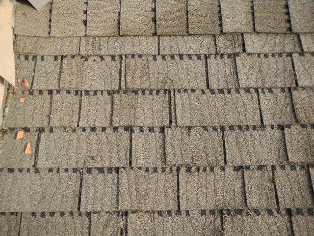

Robert Jones Posted September 21, 2013 Report Share Posted September 21, 2013 Not sure if this is a NW thing , but, I am pretty sure I was once told that these are called butterfly shingles? Could be wrong. Just trying to pin down a rough date of install. Guessing 90's. Click to Enlarge 124.79 KB Click to Enlarge 100.36 KB Link to comment Share on other sites More sharing options...
Jim Katen Posted September 21, 2013 Report Share Posted September 21, 2013 Those are Certainteed Hallmark Shangles. Probably from the early '90s. Link to comment Share on other sites More sharing options...
rkenney Posted September 21, 2013 Report Share Posted September 21, 2013 Some of those shingles manufactured between 87 and 2005 were subject to a class action lawsuit for being defective (organic shingles only). Names included Hallmark Shangle, Independence Shangle, Horizon Shangle, Custom Sealdon, Custom Sealdon 30, Sealdon 20, Sealdon 25, Hearthstead, Solid Slab, Master Slab, Custom Saf-T-Lok, Saf-T-Lok, and Custom Lok 25. Not all of the shingles marketed under those names were Certainteed Organic. Link to comment Share on other sites More sharing options...
