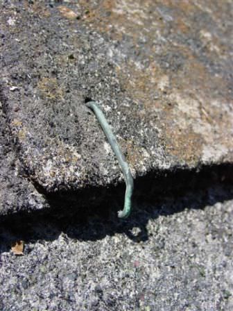

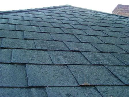

Brian G Posted September 5, 2005 Report Share Posted September 5, 2005 I did a 110 year old house Saturday with these odd shingles on the main section. I think they're asphalt or asbestos or something like that, but I thought I would consult the vast well of TIJ knowledge for possible specifics. They're about 12 - 14 inches square, roughly 1/8 inch thick, and were originally covered with green granules similar to those found on composition shingles today. They overlap left to right as well as top to bottom, held by the wire / clip in the third photo. Anybody know exactly what these are? Download Attachment: shingle2.jpg 34.07 KB Download Attachment: shingle3.jpg 39.47 KB Download Attachment: shingle1.jpg 44.45 KB Brian G. Make Me Look Good, I Don't Mind [^] Link to comment Share on other sites More sharing options...

Jim Katen Posted September 5, 2005 Report Share Posted September 5, 2005 Originally posted by Brian G. I did a 110 year old house Saturday with these odd shingles on the main section. I think they're asphalt or asbestos or something like that, but I thought I would consult the vast well of TIJ knowledge for possible specifics. They're about 12 - 14 inches square, roughly 1/8 inch thick, and were originally covered with green granules similar to those found on composition shingles today. They overlap left to right as well as top to bottom, held by the wire / clip in the third photo. Anybody know exactly what these are? If there are no photos here check back later. Brian G. Make Me Look Good, I Don't Mind [^] They look like asbestos shingles. I've never seen them laid up in dutch lap fashion like that. - Jim Katen, Oregon Link to comment Share on other sites More sharing options...
Tom Rollins Posted September 5, 2005 Report Share Posted September 5, 2005 Never seen shingle like that before and I have been doing inspection for 25+ years. From your pix they look like they are asbestos. Link to comment Share on other sites More sharing options...
Les Posted September 6, 2005 Report Share Posted September 6, 2005 I don't think they are asbestos. I think they are creosote. One way to check is how they act in temp extremes. Asbestos will remain more ridgid. However, Bond company did make a creosote asbestos impregnated product that was fastened with "belt clips". Your pics show the belt clips. Wouldn't bet anything on any of these answers, as roofing materials are extremely regional and I ain't from Mississippi! Link to comment Share on other sites More sharing options...
Brian G Posted September 6, 2005 Author Report Share Posted September 6, 2005 Whatever this stuff is made of is very hard and brittle. It won't fall apart in your hand but when you break a piece it has sharp *snap* to it. Needless to say I did not walk on it. Once you snap off a piece the edge looks light gray, almost like concrete, with no signs of a fiberous texture. Brian G. Shingle Sleuth [:-magnify Link to comment Share on other sites More sharing options...
Les Posted September 6, 2005 Report Share Posted September 6, 2005 Johns-Manville is advertising a shingle in The National Builder of March 1918 that is 90% pure asbestos in an asphalt base with granular finish. In another issue that say it can be laid in a Dutch lap. Creosote would not be gray, so maybe you have Johns-Manville. Link to comment Share on other sites More sharing options...
DonTx Posted September 6, 2005 Report Share Posted September 6, 2005 My guess would be asbestos as well. Some of the older homes in downtown Houston have asbestos shingles on them, but I don't think I've ever seen one laid in a Dutch fashion either. I believe you were working with a early 1900's roofer who was thinking outside the box. P.S. Was there any underlayment? It's common to see the shingles outlast the underlayment in this area when asbestos shingles are used. Link to comment Share on other sites More sharing options...

kurt Posted September 6, 2005 Report Share Posted September 6, 2005 If a man's library is an indicator of their cognitive ability, Les is hitting pretty high on the chart. Cool rag..... I would be very surprised if those babies weren't asbestos; I see them dutch lapped w/copper wire tabs on occasion. Dese look just like dem. Link to comment Share on other sites More sharing options...

Brian G Posted September 7, 2005 Author Report Share Posted September 7, 2005 Originally posted by Donald Lawson Was there any underlayment? It's common to see the shingles outlast the underlayment in this area when asbestos shingles are used. The only underlayment I saw was a cedar shingle roof, but I didn't screw with top stuff much. I tippy-toed up the only valley (metal, 4-5 inches wide, two stories + off the ground), took a good look around got photos of all I could see, and got the hell down. Damned stuff does last like hell though. My grandmother's house has had asbestos shingle siding since LONG before I was born, and they still look the same as they always did. Maybe we should reconsider asbestoes for outdoor use, try to combine it with something that would keep it from going friable. Brian G. Chicken...Now That's Friable [:-chef] Link to comment Share on other sites More sharing options...

mcramer Posted September 8, 2005 Report Share Posted September 8, 2005 Originally posted by Brian G. I did a 110 year old house Saturday with these odd shingles on the main section. I think they're asphalt or asbestos or something like that, but I thought I would consult the vast well of TIJ knowledge for possible specifics. They're asbestos cement. I still see a few of those here in Tampa. Link to comment Share on other sites More sharing options...
Brian G Posted September 8, 2005 Author Report Share Posted September 8, 2005 Originally posted by mcramer They're asbestos cement. I still see a few of those here in Tampa. That sounds right Mark, but where's your ancient copy of National Builder to back your version up? [] Thanks to everyone for helping out here. I don't see strange and unidentifiable materials every day, it's kind of fun. [:-party] Brian G. Dees Iz Mafia Shingles...Dey Ain't Talkin' [xx(] Link to comment Share on other sites More sharing options...
