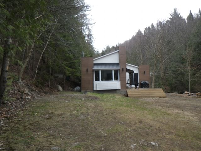

Stephen Lagueux Posted June 8, 2013 Report Share Posted June 8, 2013 Just by curiosity, do you call out the potential risks of landslides or soil collapse? Just yesterday, about 40 minutes from my place, this house was dammaged by this collapse due to the constant rain of the past 2 weeks. Click to Enlarge 68.49 KB On a recent inspection, I did mention the risk of landslide, tumbling rocks or falling tree that could happen due to heavy rain or wind from which could cause damage to this house that was built right at the bottom of this very abrupt mount side. Click to Enlarge 57.84 KB Is it going above and beyond the sop? Maybe, but if I see something that can pose a risk, I will certainly call it out. How about you? Link to comment Share on other sites More sharing options...

Jim Katen Posted June 9, 2013 Report Share Posted June 9, 2013 I always point it out when a house has inadequate clearance to either an ascending or descending slope. Neither one ever gets farther away from a house, they only get closer. If I'm really concerned about movement, I send them to a good geotech. Hiring the geotech often turns out to be the best money they've ever spent. Link to comment Share on other sites More sharing options...

John Kogel Posted June 11, 2013 Report Share Posted June 11, 2013 Stephen, I made light of your post earlier, but there are areas here, such as North Vancouver heading to Squamish, where mudslides are a very real threat. Still, it is more in the domain of the seller and realtor, so I would let it come from their mouths first if possible. Certainly I would describe the steep slope of the site in my report. Link to comment Share on other sites More sharing options...
