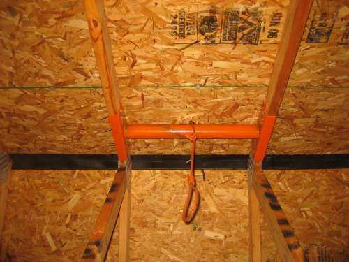

ramdino Posted May 22, 2013 Report Share Posted May 22, 2013 What the heck is this. I think I know. It is attached to a group of piggy back trusses in the center. It looks like a lift bar from construction. It is in the center of the group so that makes sense. Another question is why did they switch from normal trusses to piggy back trusses. Is it because there is a 2 story vaulted celling on the other side of the ridge. I think I answered my own question. Click to Enlarge 39.42 KB Click to Enlarge 31.62 KB Link to comment Share on other sites More sharing options...
Jim Katen Posted May 22, 2013 Report Share Posted May 22, 2013 The bar looks like an improvised fall protection anchor. Link to comment Share on other sites More sharing options...

GAHI of KC Posted May 23, 2013 Report Share Posted May 23, 2013 I agree. It looks like some sort of a lifting mechanism. Let us know if you find out differently. Link to comment Share on other sites More sharing options...
hausdok Posted May 23, 2013 Report Share Posted May 23, 2013 Just follow Joe's link above. He's got a photo of one in use. ONE TEAM - ONE FIGHT!!! Mike Link to comment Share on other sites More sharing options...
Inspectorjoe Posted June 2, 2013 Report Share Posted June 2, 2013 I had three of them in this afternoon's attic. You can see the hole that was punched in the sheathing to get the cable outside. Click to Enlarge 56.75 KB Link to comment Share on other sites More sharing options...
