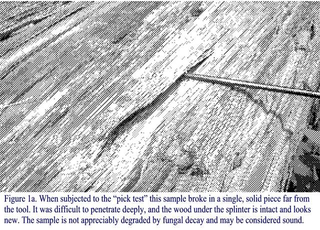

The test involves using an ice pick to penetrate the wood surface in an area where fungal decay is likely or suspected. Similar tools such as an awl or even a small screwdriver can also be used. After penetrating the wood, the tool is rotated to pry a splinter, parallel to the grain, away from the surface. The appearance of the broken splinter is then used to determine if the piece is decayed.
Because different species have different densities and all lumber is affected to some degree by its environment, applying the pick test in an area where the wood is known to be sound is a recommended means of establishing a "control"? for the remainder of the inspection. The test should be conducted in a late-wood zone (the darker and more dense wood fiber that forms during the later, dry part of the yearly growth cycle), although the test may also work in early wood zones. Then begin testing areas that are conducive to fungal decay, noting how much pressure is required to penetrate the surface. The penetration depth should be about ?-inch (6.4 mm). Pry out a small amount of the surface wood and compare the results to those of the non- decayed "control"? sample.

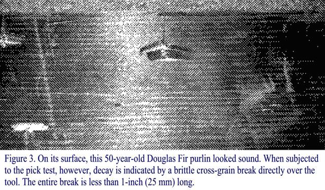

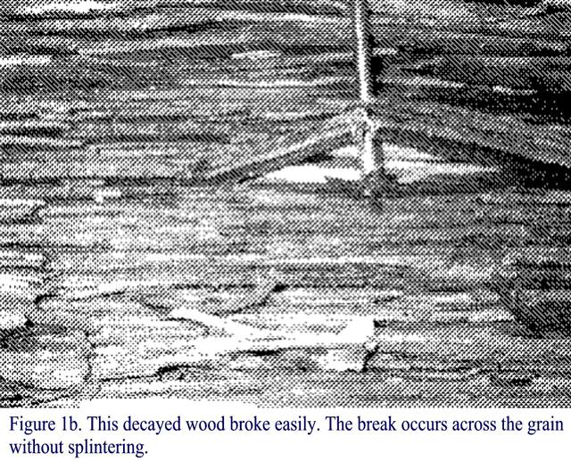

200755213340_picktest1.jpgWilcox (1983) identifies three distinct modes of failure for decayed and non-decayed wood. Non-decayed wood will generally fail with either a fibrous failure or a splintering break, as shown in Figures 1a and 2 (Click images to enlarge). Decayed wood will have a brash, brittle failure with breaks directly over the tool. Very few splinters, if any, will appear and the break will occur across the grain, as shown in Figures 1b and 3. The samples pictured in Figures 1a and 1b were taken from a salvaged Douglas Fir log yard. Because the exterior of each is similarly weathered, they could be mistaken for being in comparable condition based solely on visual inspection.

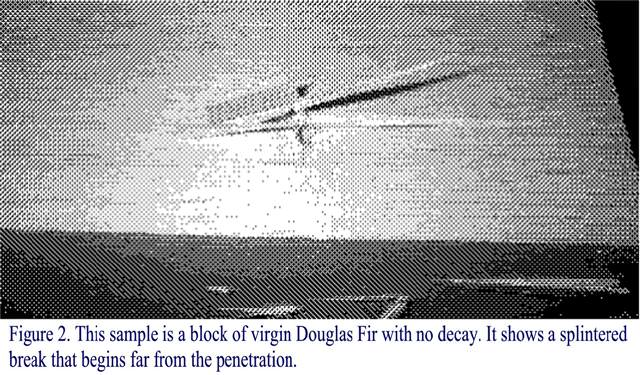

In a fibrous failure, the splinters are long and separate from the surface far from the tool, as shown in Figure 2 (virgin Douglas Fir), whereas a splintering break typically occurs directly over the tool with numerous splinters. Sound wood is very dense and in such good condition that penetration is difficult. The sound caused by the break can also be an indication of the quality of the wood. With non-decayed wood, the sound will be what one expects to hear when wood breaks. In contrast, when decayed wood breaks the sound will not be as loud and is sometimes barely audible.
