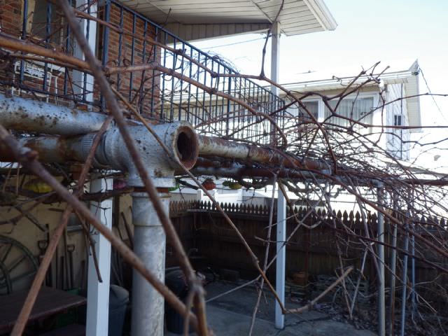

I couldn't help but think of this thread during an inspection this morning. I got the inspection because of a ladder accident.
The gentleman who had owned the house grew grapes on this trellis. He was on a stepladder, picking them, and was probably no more than a foot or two off the ground. See the open tee? There's a piece of rusted pipe in there. Instead of moving the ladder, the guy leaned out further than he should have and grabbed onto the pipe that used to be there. It snapped off, and he went headfirst into the patio slab.
Dead, with a widow left behind because of a stupid shortcut on a ladder.

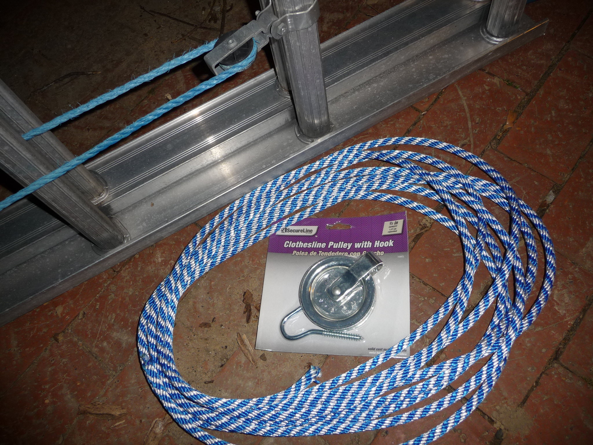

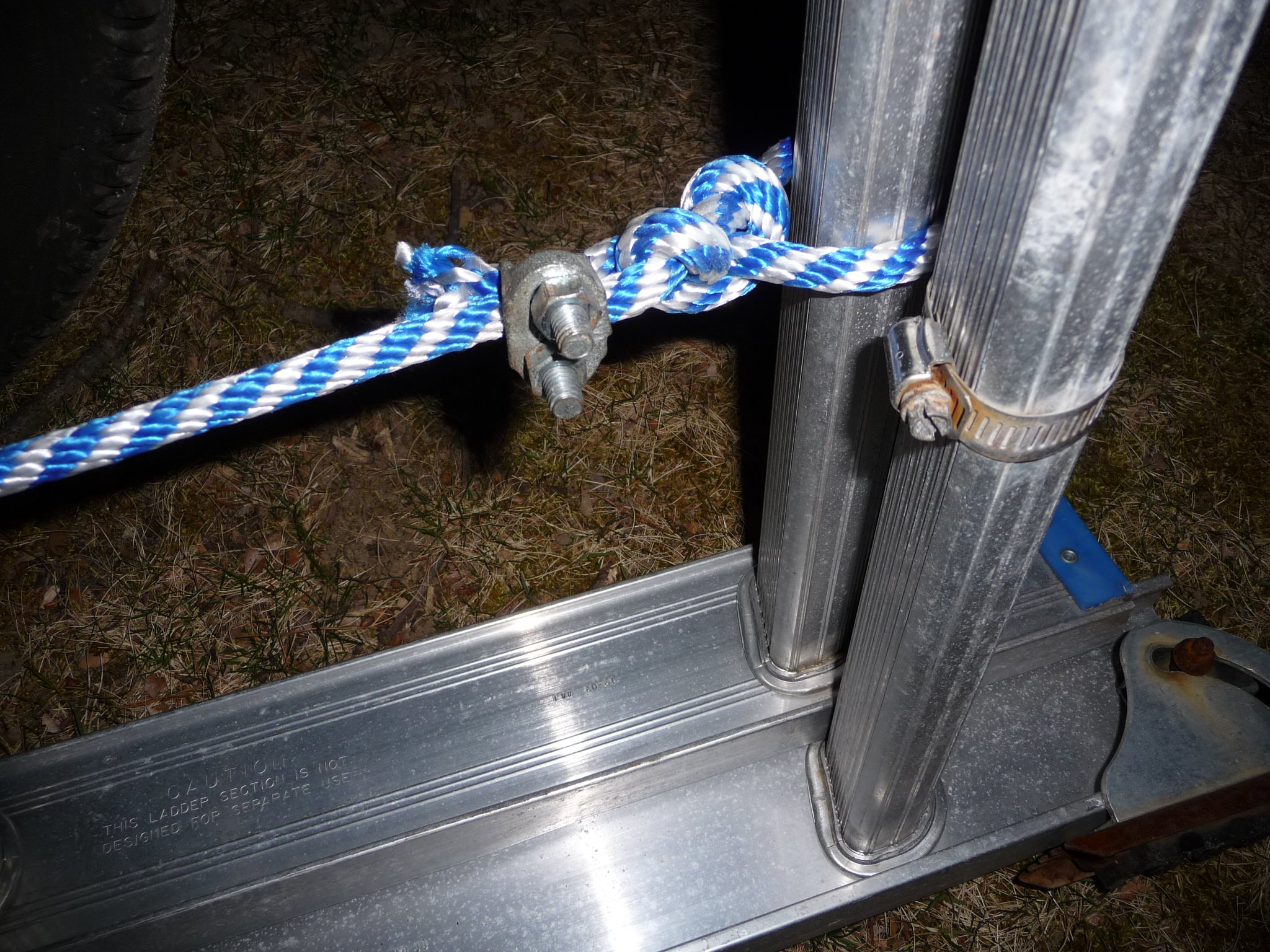

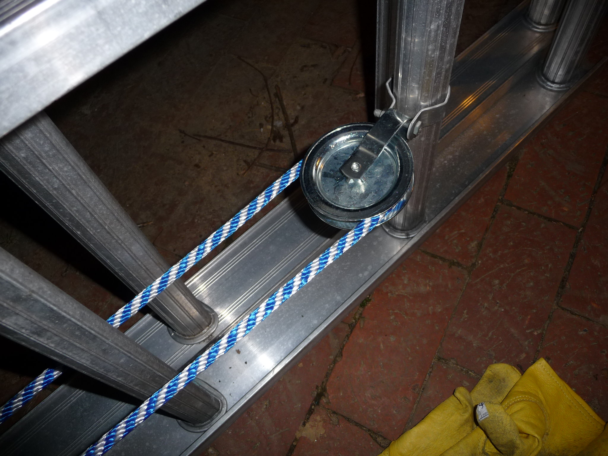

32' of 3/8" poly braid from Lowes. $4 clothesline pulley from Walmart.
The larger pulley surely makes retraction easier. It requires less friction from grip on the rope as the top section slides down. Less wear on the gloves too.

Nice one, John. The plain Jane pulley looks like it belongs there. Nice rope that will last. Gloves are good.
I just wish you had used a Bowline knot on the rung. That is the knot that won't undo itself. Melt the end of the rope too, eh? [:)]
Posted
On second thought, the size of the pulley won't change the effort required. Not with a single pulley. In order for there to be a change in required effort you would need two or more pulleys of differing sizes to make a ratio change.
Do I have this correct?
However, I think the radius of a larger pulley reduces the stress on the rope.
Posted
Four ropes takes 1/2 (2/4) the force of two but takes twice as long to get it up.

With only one pulley, you have to pull with a force equal to the weight of the moving section of the ladder. If you add a second pulley that travels on the moving section, you'll only have to pull half the weight of the moving section, but for every foot you pull, the section will only move 6". The size of the pulleys doesn't affect the mechanical advantage of the system. All of this assumes no losses due to friction.
The size of the sheave affects friction losses, especially with cheap pulleys like the ones you're using. Larger sheaves have lower losses and, as you say, place less stress on the rope. If you wanted to get fancy, you'd buy a pulley with bearings. But before you do that, polish the business ends of the dogs to make them less likely to stick on the way up - especially if it's a big ladder.
Posted
That's right, the big pulley reduces friction, so it is an easier pull, and it reduces strain on the rope.
For a mechanical advantage, you need to add another pulley at the bottom and run the rope back up to the top.
Too much rope doing it that way. Install a little winch on there that you can run with a cordless drill. [:)]
Posted
How does a bigger pulley reduce friction?
I don't suppose it actually reduces the friction itself, but it reduces losses to friction. It's simple leverage.
Posted
With the exception of a smaller pulley maybe having more slippage, I don't understand how a larger one reduces losses to friction. The rope and pulley should be turning at the same speed, so there shouldn't be any friction there. The only appreciable friction would be at the shaft. I suppose a smaller pulley turning faster would generate more friction, but I can't see that making much of a difference.
What am I missing?
Posted
What am I missing?
There's friction at the shaft, which is overcome more easily with a bigger sheave.
There's also another type of friction, similar to rolling friction on a wheel. It has to do with the deformation of the rope as is engages the groove on the sheave on one side and disengages from it on the other side. That friction is reduced with a larger sheave just as rolling friction is reduced with a larger wheel.
The effect is probably small, but my hunch is that it's noticable.
