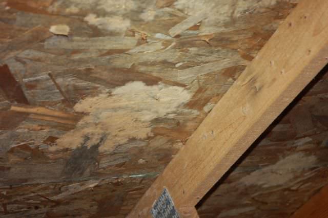

randynavarro Posted March 5, 2013 Report Share Posted March 5, 2013 Never seen it before. . . North side of roof. Not consistent throughout, only random spots. Any ideas? Click to Enlarge 43.75 KB Click to Enlarge 51.25 KB Click to Enlarge 33.05 KB Link to comment Share on other sites More sharing options...
Scottpat Posted March 5, 2013 Report Share Posted March 5, 2013 The nails in those areas are rusty so we know it is moisture related. I would be looking at ventilation and or something pumping up moisture/warm air into the attic under or near that area. Link to comment Share on other sites More sharing options...
kurt Posted March 5, 2013 Report Share Posted March 5, 2013 Yep. OSB is lunch for some organisms. Link to comment Share on other sites More sharing options...
John Kogel Posted March 5, 2013 Report Share Posted March 5, 2013 I'd call that a wood-loving fungus. [] We see that fungus on wood in the lumber yard, where planks have sat too long in the rain. Or just out in the bush. Each plant spreads out from a central point. I'll venture to say that it will be hard to eliminate, because that type will draw moisture from the wood itself. It's not the typical mold that drifts in later. Link to comment Share on other sites More sharing options...
hausdok Posted March 5, 2013 Report Share Posted March 5, 2013 North slope, No sunlight. The underside of the deck stays cool from October to May regardless of how sunny it is outside. Fungi abides. Did you check the whole house air change timer? Were they even using it? If they were, were they running the system long enough to be effective? Look behind the dial. They often look fine but they aren't working 'cuz the springs are broken (see photo below from a 4 year old home). Click to Enlarge 28.95 KB Without anything removing the moisture from the house, it migrates by diffusion into the attic and ends up condensing on the cool underside of the north slope. The fungi was already there; it just needed enough moisture to sustain it and allow the spores to multiply faster than they die off - something they can't normally do on the south and west slopes, and sometimes the east slope, 'cuz those sides get enough sunlight to stay warm enough to evaporate the moisture. Ten years ago we'd have told them to treat it with some Cuprinol and go on with their lives. Now the only safe (for your livelihood) thing to do to avoid the "toxic mold" crazies from talking folks into suing you is to recommend they get it professionally abated or the subject will come up again when they go to sell the home. ONE TEAM - ONE FIGHT!!! Mike Link to comment Share on other sites More sharing options...

mlparham Posted March 12, 2013 Report Share Posted March 12, 2013 Never seen it before. . . North side of roof. Not consistent throughout, only random spots. Any ideas? Click to Enlarge 43.75?KB Click to Enlarge 51.25?KB Click to Enlarge 33.05?KB Water in the crawl space or basement. Link to comment Share on other sites More sharing options...
Tom Raymond Posted March 12, 2013 Report Share Posted March 12, 2013 Morgan, you do realize those are roof trusses in the pics, right? I have only ever been in one house where the moisture in the crawl was contributing to the fungal forest in the attic. The most cost effective way to air seal it would have been to bulldoze it and start over. If this is how you inspect, remind me never to stand on or under anything you've engineered. Link to comment Share on other sites More sharing options...
Jim Katen Posted March 13, 2013 Report Share Posted March 13, 2013 I see wet crawlspaces contributing to attic moisture problems regularly. Link to comment Share on other sites More sharing options...
kurt Posted March 13, 2013 Report Share Posted March 13, 2013 Same here. Common. Link to comment Share on other sites More sharing options...
