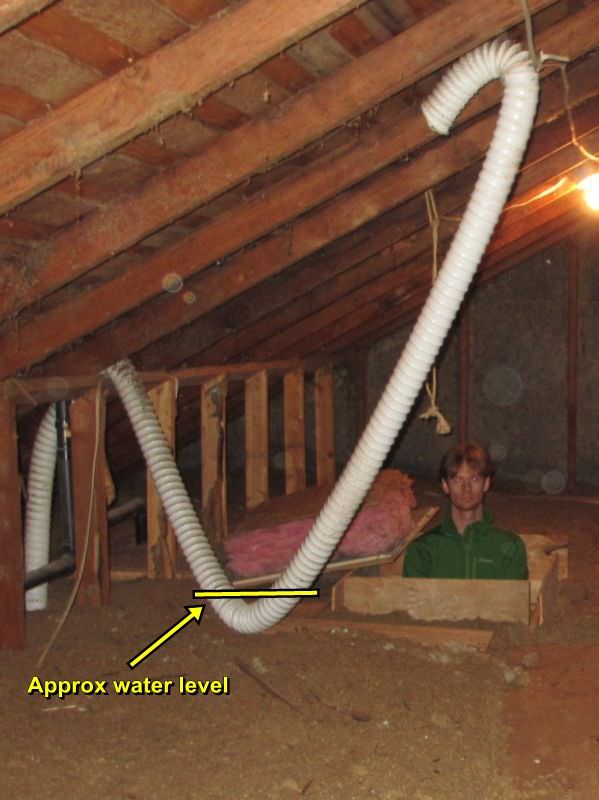

Richard Moore Posted February 22, 2013 Report Share Posted February 22, 2013 I'm sure we are all aware of the condensation problem with bathroom exhausts venting through uninsulated ducts in a cold attic, but this is the most extreme example I have ever seen. Click to Enlarge 69.48?KB Judging from the weight, there was at least a full gallon of water in the duct, to a level that the air-flow was completely blocked. Kind of amazing it hadn't leaked...yet. Ignoring the fact that it doesn't vent to the exterior (and the oddly creepy shot of my client) that is one big-ass future ceiling stain. Link to comment Share on other sites More sharing options...
