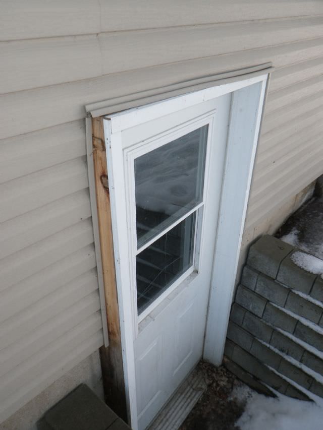

Stephen Lagueux Posted February 18, 2013 Report Share Posted February 18, 2013 Click to Enlarge 56.01 KB Click to Enlarge 54.08 KB Link to comment Share on other sites More sharing options...
Jim Baird Posted February 18, 2013 Report Share Posted February 18, 2013 ...the installer of the door knew the old rule, "if it don't fit don't force it!" Link to comment Share on other sites More sharing options...
John Kogel Posted February 19, 2013 Report Share Posted February 19, 2013 It looks like the door got slammed out of shape, was never nailed. Link to comment Share on other sites More sharing options...
Stephen Lagueux Posted February 19, 2013 Author Report Share Posted February 19, 2013 The frame was screwed in using 3/16 tapcons that broke right off. Link to comment Share on other sites More sharing options...
Tom Raymond Posted February 19, 2013 Report Share Posted February 19, 2013 Because the casings are missing. No brickmold, no drip cap, no interior trim. The screws were assaulted from all sides. They never had a chance. Same thing happens when the 'installer' only fastens the jamb through the brickmold. Link to comment Share on other sites More sharing options...
