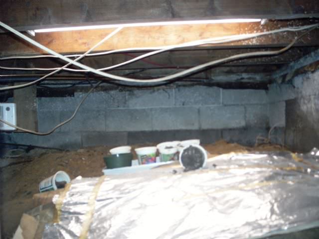

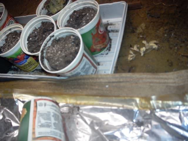

Stephen Lagueux Posted January 23, 2013 Report Share Posted January 23, 2013 Except on one occasion where I found a few planting pots with dried up marijuana seedlings in a crawl space, I have never come across one of those major grow houses. I told my client that there were signs telling me that the crawl space had been used as a nursery. Nothing big, but it was there nonetheless. Click to Enlarge 46.44 KB Click to Enlarge 49.09 KB The usual warning signs when inspecting go as follow: Presence of mold; Unusually high number of roof vents; Evidence of tampering with the electric mast, the meter or the ground around it; Concrete masonry patches; Patterns of screw holes in the walls (shelves); Circular marks on concrete floors in the basement where pots once were; Presence of aluminum foil; Extra light wiring, etc. Have you ever inspected a grow house? What signs have you found that raised a red flag and how would you tell your client that the house he wants to buy was used to grow marijuana? Link to comment Share on other sites More sharing options...

Stephen Lagueux Posted January 23, 2013 Author Report Share Posted January 23, 2013 Well, over here in Quebec, everything that is related to cannabis is pretty much illegal. Many will rent out houses in rural area and will transform them from basement to attic and then move on somewhere else. These guys don't care and the house will be a real mess. The worst damage found in these houses will come from mold and I've heard of houses that had to be entirely gutted. Those pictures of plant pots don't prove anything. It could've been tomatoes for all I know but I told my client that there had been some kind of horticulture activities in the crawl space. You're right though, no one should mention the words grow house, pot, etc. especially in the report. But the fact remains that our clients have the right to know of the signs we find that make us believe of such a thing. Link to comment Share on other sites More sharing options...
