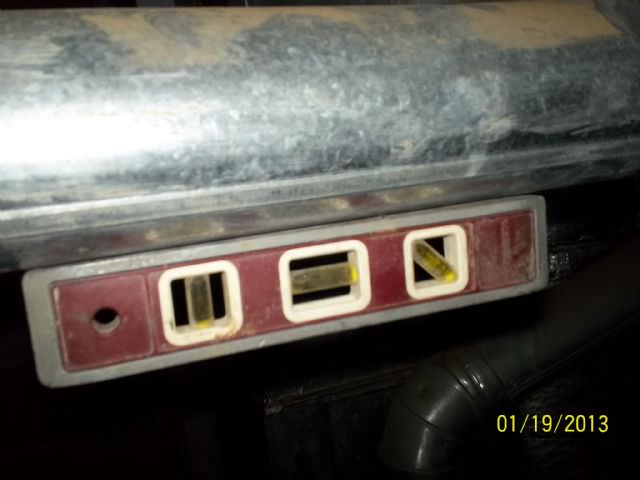

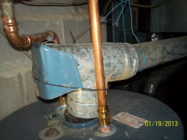

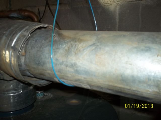

Phillip Posted January 22, 2013 Report Share Posted January 22, 2013 So many things wrong. No vent hood. A tee instead of a ninety. Pipe is not the same size as the tee and it runs down hill Click to Enlarge 44.63 KB Click to Enlarge 34.53 KB Click to Enlarge 35.61 KB Link to comment Share on other sites More sharing options...
gtblum Posted January 22, 2013 Report Share Posted January 22, 2013 Well Phillip, at least you can confirm it's made out of gen-u-wine steel. Link to comment Share on other sites More sharing options...
Brandon Whitmore Posted January 22, 2013 Report Share Posted January 22, 2013 The burner cover tee cap is a nice touch. Link to comment Share on other sites More sharing options...
John Kogel Posted January 22, 2013 Report Share Posted January 22, 2013 That looks like something a moonshiner would build. In the dark. With an open jar of shine at his side. [] Link to comment Share on other sites More sharing options...
Jim Baird Posted January 22, 2013 Report Share Posted January 22, 2013 also missing is the "built by bubber" sticker... Link to comment Share on other sites More sharing options...

John Kogel Posted January 23, 2013 Report Share Posted January 23, 2013 Phillip, I see you used your level on that thing. I think the big hammer would have been the correct tool to use there. [] Link to comment Share on other sites More sharing options...
Phillip Posted January 27, 2013 Author Report Share Posted January 27, 2013 Phillip, I see you used your level on that thing. I think the big hammer would have been the correct tool to use there. [] But it was not mine to use an hammer on.[:-censore[:-slaphap Link to comment Share on other sites More sharing options...
