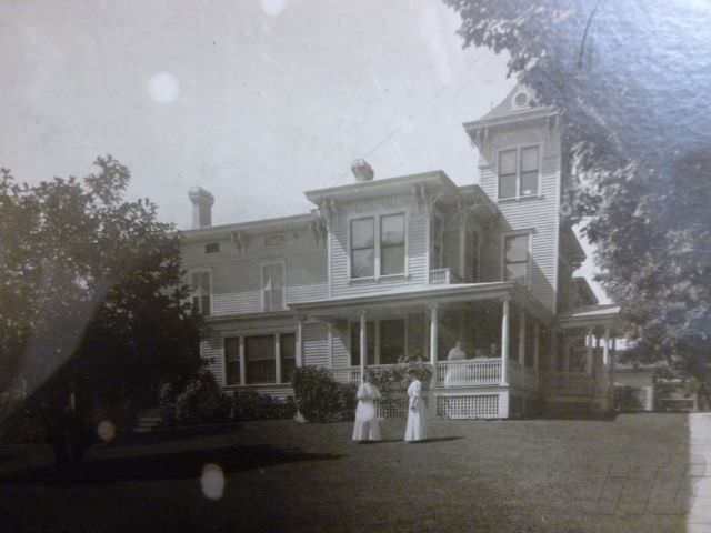

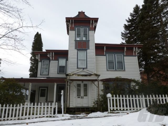

gtblum Posted January 20, 2013 Author Report Share Posted January 20, 2013 Thanks, Bill. Who are the three? Here's the old girl in her glory and another from yesterday. I'd love the chance to be involved in the restoration of this place. Click to Enlarge 40.66 KB Click to Enlarge 61.93 KB Link to comment Share on other sites More sharing options...
