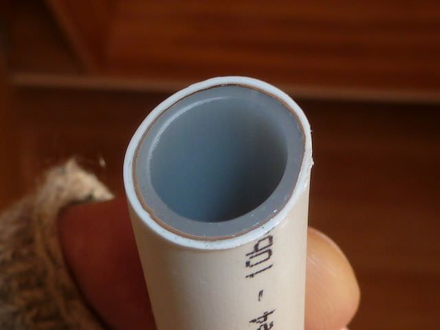

Marc Posted January 5, 2013 Report Share Posted January 5, 2013 All this is starting to make me wish I could visit China. It was interesting and educational to learn how things are up in northern USA and Canada when I first joined this forum years ago. These posts from our ambassador to China takes it to a whole new level. Is that PEX encased in PVC? Marc Link to comment Share on other sites More sharing options...

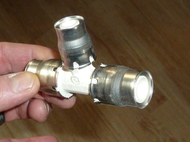

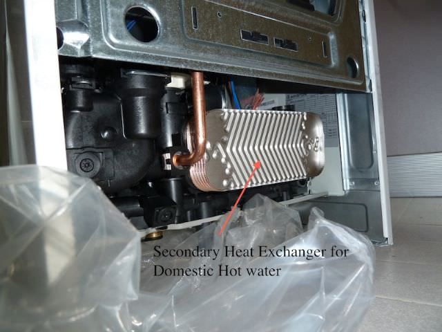

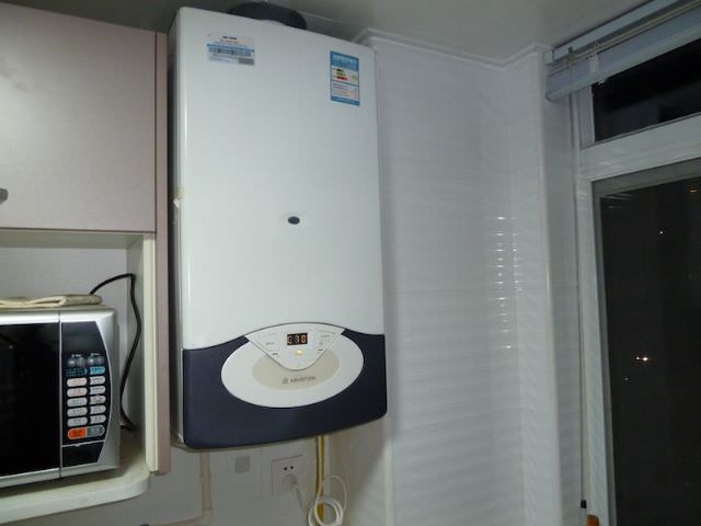

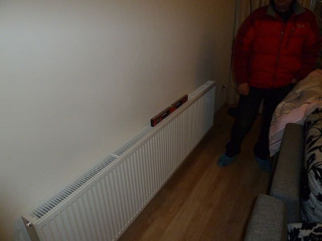

kurt Posted January 5, 2013 Report Share Posted January 5, 2013 It's aluminum sandwiched in PEX and (I think) PVC. It's damn nice stuff. So are the radiators and all the components. All the valves are gates, with the gates being a really nice machined brass design. Nice, heavy, perfect fit kind of stuff. What else would I expect from Germans? I can't read Chinese characters on the invoice and all the websites are in German, Polish, Arabic, or some other language I can't read. There's only one PLACE I've found in the US that handles some of this stuff. The radiators are Purmo from Poland. Pipe and fittings are Frankeische alpex duo from Germany Boiler is Ariston from England. All this stuff is amazingly cheap in China, and I don't think we can even get any of it in the USA. Internet here absolutely SUCKS....slow, blocked, ridiculously stupid. You can research it better from there than I can from here. I only get to see it. Link to comment Share on other sites More sharing options...
Marc Posted January 5, 2013 Report Share Posted January 5, 2013 Maybe it's this. Marc Link to comment Share on other sites More sharing options...
kurt Posted January 6, 2013 Report Share Posted January 6, 2013 It's similar but only 3 layers. I was finally able to get into the Frankeische site.....it's PEX, Aluminum (oxygen/gas barrier), and Polyethylene outer sheath. It's an extremely cool system. Link to comment Share on other sites More sharing options...
Marc Posted January 6, 2013 Report Share Posted January 6, 2013 I think the other two layers are adhesives and PEX is cross-linked polyethylene. Marc Link to comment Share on other sites More sharing options...
