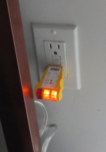

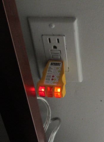

Richard Moore Posted December 7, 2012 Report Share Posted December 7, 2012 This "amused" me for a while today. I tripped an exterior receptacle with a GFCI tester and heard the click coming from the nearby interior. OK so far. Later, when I'm in that room, I find the GFCI contaminated with paint and had trouble resetting it. With a basic 3-light tester in place, I finally manage to get it to turn on, but find it indicating reverse polarity. I take a picture (for my notes). Click to Enlarge 16.07?KB I then turn to my client who happens to be in the room and turn back to point out the offending GFCI receptacle, that mostly needs replacing because of the paint. And, as if it had had a quick trip to Lourdes while I had my back turned, it healed itself! Click to Enlarge 13.43?KB Subsequent trips and resets resulted in more momentary flashes of reverse polarity (less than a second) and then, voila, fine again. I suspect this has something to do with the paint slowing down the buttons, but I have never seen one behave like this. Something in the internal circuitry causing this? Link to comment Share on other sites More sharing options...

Marc Posted December 7, 2012 Report Share Posted December 7, 2012 In John's picture of the autopsied tester, if the bared conductors which cross each other were to touch, voltage to one led would become divided between two of them and cause the middle led to lose voltage. LED's are funny, they'll illuminate with just half as much voltage. I think Richard's receptacle does indeed have a reversed polarity condition. He needs a new tester too, or open it up like John did and separate the two crossed conductors. Marc Link to comment Share on other sites More sharing options...

Garet Posted December 7, 2012 Report Share Posted December 7, 2012 I see this once or twice a year. It's not "ordinary" reverse polarity between hot and neutral, instead it's reversed between hot and ground (at least that's what my 3-light tester tells me). That means any metal-cased appliance is now energized to the touch. I write them up as defective. They always re-trip when I push the test button again, and I've always been able (eventually) to get them to re-set in the normal position. Sometimes I have to re-test/re-set more than once. Link to comment Share on other sites More sharing options...

Richard Moore Posted December 7, 2012 Author Report Share Posted December 7, 2012 Tester worked normally in all other receptacles and I had similar results with a different tester in the same GFCI (just not the initial long interval between readings). Link to comment Share on other sites More sharing options...

Jim Katen Posted December 8, 2012 Report Share Posted December 8, 2012 This "amused" me for a while today. I tripped an exterior receptacle with a GFCI tester and heard the click coming from the nearby interior. OK so far. Later, when I'm in that room, I find the GFCI contaminated with paint and had trouble resetting it. With a basic 3-light tester in place, I finally manage to get it to turn on, but find it indicating reverse polarity. . . . This used to be quite common with older GFCI devices. We've had discussions about it in the past. With some of them, you could induce this condition by tripping the GFCI and then resetting it by pushing on only one side of the button or by only pushing the button partway in. It seems like I used to get questions about it every few months. Now, with the newer GFCIs, it hardly ever seems to happen anymore. Link to comment Share on other sites More sharing options...
inspector57 Posted December 8, 2012 Report Share Posted December 8, 2012 Ditto what Katen said. Certain vintage GFCI do this with surprising frequency in my experience. Link to comment Share on other sites More sharing options...
