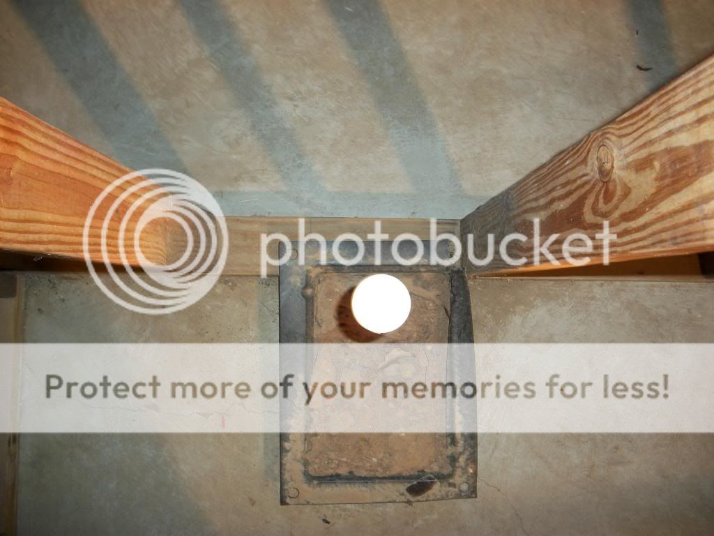

JosephVelder Posted December 3, 2012 Author Report Share Posted December 3, 2012 I never heard back from Randy so I'm back to ask ya'lls opinions This is the wall in question, It looks to me that the drain for the bath tub is to close to the wall so if I make the wall 2x6 it will make this worse right? does this look right to you guys? or is do I "T" the tub drain into that pipe and it also connects to the overflow? I've never installed a tub before...obviously. Link to comment Share on other sites More sharing options...
Marc Posted December 3, 2012 Report Share Posted December 3, 2012 I don't see the need for a 2X6 wall. That looks like a 3" vent stack. Just install listed metal strips on all 3 plates to keep errant drywall nails from puncturing the pipe. I framed for years but plumbing isn't my forte. If you need a copy of the Louisiana Plumbing Code, there's one here. It's 178 pages! [:-bigeyes Marc Link to comment Share on other sites More sharing options...
