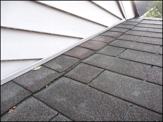

John Dirks Jr Posted November 18, 2012 Report Share Posted November 18, 2012 I've not seen this done before. Why would a roofer add this extra layer of shingle detail at the rood to sidewall junction? Click to Enlarge 62.66 KB Link to comment Share on other sites More sharing options...
Marc Posted November 18, 2012 Report Share Posted November 18, 2012 To hide and/or remedy badly corroded 'J flashing'? If anyone can think of a better term than 'J flashing', I'm all ears. Marc Link to comment Share on other sites More sharing options...
Jim Katen Posted November 18, 2012 Report Share Posted November 18, 2012 To hide and/or remedy badly corroded 'J flashing'? If anyone can think of a better term than 'J flashing', I'm all ears. Marc You think there's flashing under there? Link to comment Share on other sites More sharing options...
Marc Posted November 18, 2012 Report Share Posted November 18, 2012 It'd leak on the first decent rainfall if it didn't. Marc Link to comment Share on other sites More sharing options...
Bill Kibbel Posted November 18, 2012 Report Share Posted November 18, 2012 They added step flashings after discovering they were omitted when the roof cover was installed. Link to comment Share on other sites More sharing options...
Jim Katen Posted November 18, 2012 Report Share Posted November 18, 2012 It'd leak on the first decent rainfall if it didn't. Marc I'm thinking that those *are* the step flashings. Link to comment Share on other sites More sharing options...
John Dirks Jr Posted November 18, 2012 Author Report Share Posted November 18, 2012 Here's what I said. At two locations on the roof where roof slopes meet exterior sidewalls, there's an extra layer of shingles along the edge. This condition made it more difficult to check for proper step flashing without the possibility of causing damage. Since I'm not equipped to repair any damage that I might cause by checking for step flashings, I elected not to do it. There are some other roofing repairs that need to be done on this house. While the contractors are here for those roof repairs, have them check for proper step flashings at roof slopes to sidewall junctions and correct if needed. Link to comment Share on other sites More sharing options...
Tom Raymond Posted November 18, 2012 Report Share Posted November 18, 2012 It'd leak on the first decent rainfall if it didn't. Marc I'm thinking that those *are* the step flashings. Me too. Link to comment Share on other sites More sharing options...
