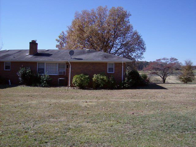

Jim Baird Posted November 11, 2012 Report Share Posted November 11, 2012 This 1970 ranch looked good sitewise, positive slope on three of four sides, gutters and wide overhang, but some dips and low spots in floors were troubling. Not many vents in foundation wall. Soon as crawl was entered, first stab with probe sank to hilt, and never got better. Worst I have seen, no termite, all mold. Gut job to fix. Buyer not very encouraged, to say the least. Click to Enlarge 47.09?KB Click to Enlarge 40.19?KB Click to Enlarge 43.2 KB Link to comment Share on other sites More sharing options...
hausdok Posted November 11, 2012 Report Share Posted November 11, 2012 You can see a water line around the perimeter on the block. They must have a pond under there in the rainy season. ONE TEAM - ONE FIGHT!!! Mike Link to comment Share on other sites More sharing options...
Jim Baird Posted November 11, 2012 Author Report Share Posted November 11, 2012 The water line could be from some history too. Unoccupied for six yrs but utlilies on for duration, note from plumber written in June this yr, apparently when decision to sell occurred, said he replaced WC that was leaking. Last occupant was widow who lived alone there many yrs. Her departure left everything untouched, toothbrush on the sink, food in fridge, creepy in its way. Active leak could have made a lake over so much time's passage. Link to comment Share on other sites More sharing options...
