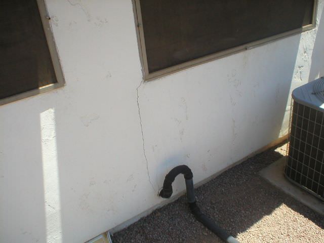

macavoy Posted July 18, 2005 Report Share Posted July 18, 2005 Hello, Im an appraiser and am curious if you guys would have any concerns with the attached picture?? Cracked stucco. Im guessing its just the stucco and not an inicator of something else?? The windows/doors showed no other cracks and I had no trouble opening doors. I see hairline cracks alot on stucco but this is a bit thicker. Thank you. Download Attachment: Picture 9095.jpg 381.91 KB Link to comment Share on other sites More sharing options...
DonTx Posted July 18, 2005 Report Share Posted July 18, 2005 My concern with that crack would be water intrusion. However, I'm guessing that's not a real beig issue there in the Land of the Sun. A patch and paint job should have you good to go in no time. Link to comment Share on other sites More sharing options...
Scottpat Posted July 18, 2005 Report Share Posted July 18, 2005 That is not a normal curing crack, something has caused it. Link to comment Share on other sites More sharing options...
chrisprickett Posted July 18, 2005 Report Share Posted July 18, 2005 Originally posted by macavoy Hello, Im an appraiser and am curious if you guys would have any concerns with the attached picture?? Cracked stucco. Im guessing its just the stucco and not an inicator of something else?? The windows/doors showed no other cracks and I had no trouble opening doors. I see hairline cracks alot on stucco but this is a bit thicker. Thank you. Download Attachment: Picture 9095.jpg 381.91 KB I do a ton of inspections in Surprise. Because of the location of the crack, it's likely from a combination of a stress crack from the corner of the window, and vibration of the coolant line. If I saw that on an inspection, I'd check for signs of moisture intrusion, and if there was none, I'd recommend sealing it. If there's no active moisture issue, and there are not a bunch more like it, it's no big deal. Link to comment Share on other sites More sharing options...
stuccoman Posted December 11, 2005 Report Share Posted December 11, 2005 Originally posted by macavoy Hello, Im an appraiser and am curious if you guys would have any concerns with the attached picture?? Cracked stucco. Im guessing its just the stucco and not an inicator of something else?? The windows/doors showed no other cracks and I had no trouble opening doors. I see hairline cracks alot on stucco but this is a bit thicker. Thank you.Download Attachment: Picture 9095.jpg 381.91 KB That looks like a paperback lath crack!!! This happens when the lath and paper are cut on the same line and it does not let the stucco key to all the lath! http://www.badstucco.com/improperprep/p ... %20032.htm Hope this helps! Link to comment Share on other sites More sharing options...
