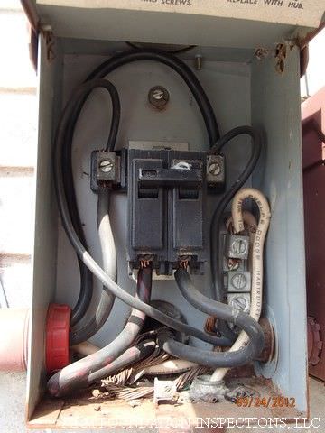

42 year old home, overhead electrical entrance. Would you say this main panel is ok considering the age of the home or would you write it up as needing to be evaluated and repaired by an electrician?

Posted
Thanks Charlie. Thats what I put in the report but the electrician the seller called said it's fine and now they don't want to repair it due to the $800 cost to upgrade the panel.

This is why it's important to know what's wrong with it; kicking it to an electrician means it's going to their electrician, who probably did the work. They're not going to condemn themselves.
Unless you can line item what's wrong, and challenge the electrician to respond in writing to specifics, you're always going to get that sort of answer.

The electrician also has a conflict of interest. He benefits from the sale if he tells the client the panel needs replacement. Panel replacement is a quick money maker. That's enough for many of them to say 'ya gotta change it'.
I'm with Neal. Correct the double tap. I can't discern any issue with the disconnect from the photo alone.

Those lugs are designed for one large gauge conductor only. This 'electrician' says that it is alright to have those smaller gauge conductors tapped in there?
Have him put it in writing that it is safe and correct, otherwise, your client wants it repaired.

If you know it is wrong then leave off the evaluated part and write it up as correct the incorrect wiring.
