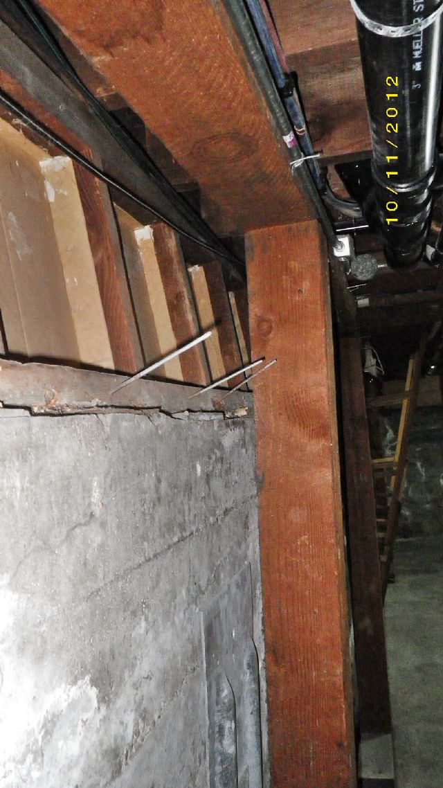

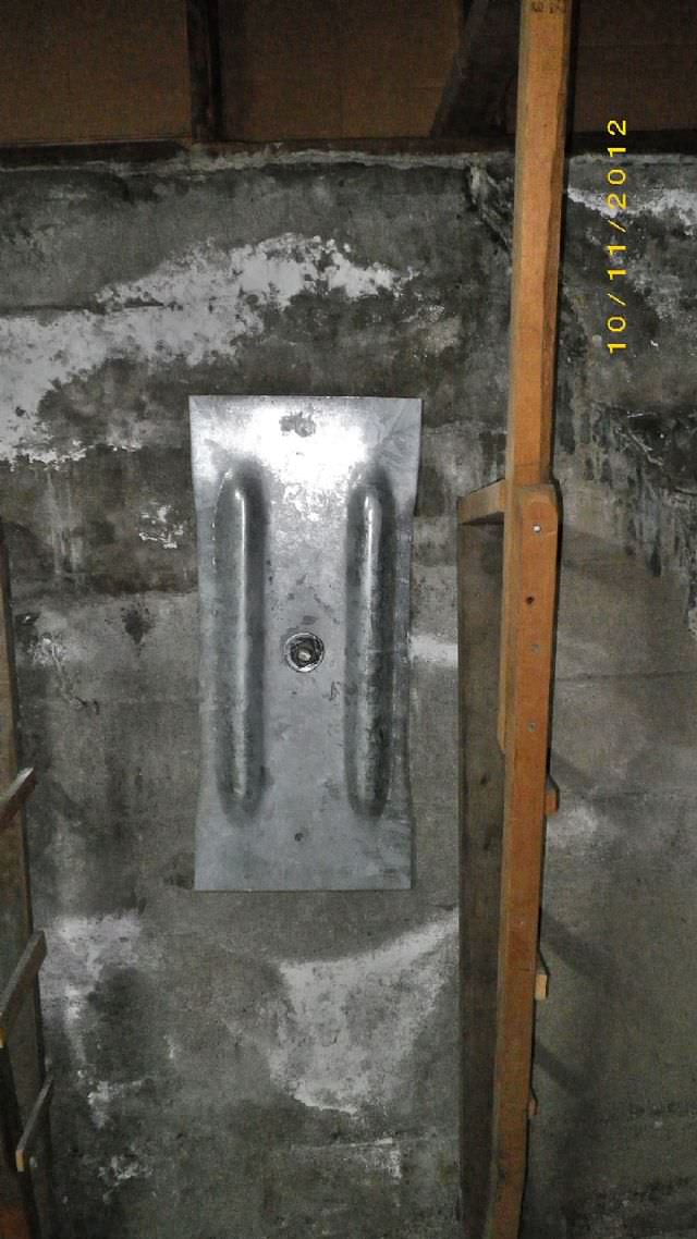

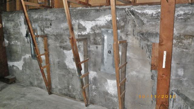

Robert Jones Posted October 12, 2012 Report Posted October 12, 2012 100 year old home. Obvious wall failure that, according to my clients, had been repaired(pinned?). They were told that the metal bracket would need to be tightened monthly. According to my client, the company that did the install, states in their paperwork that they are not structural engineers and that it is up to the client to get that "inspection" if desired. I personally don't know enough about this type of system(first time in 10 years seeing this) to make an educated call to my clients. I do however feel that the services of a structural engineer would a good thing. Any recommendations/advice on this one? Update: The system is called Grip-Tite Wall Anchor System. Click to Enlarge 49.27?KB Click to Enlarge 130.73?KB Click to Enlarge 126.67?KB
hausdok Posted October 12, 2012 Report Posted October 12, 2012 Hi Rob, Well, I think calling for an engineer is the right call; although I don't think the client will get much out of it. I can imagine the engineer saying something like, "Well, what they've done might be just fine or it might not; without seeing exactly what they've done here and why they've done it, I can't be absolutely certain." ONE TEAM - ONE FIGHT!!! Mike P.S. I wonder what tightening that nut is designed to do every month with that kind of pressure on the other side of that wall? Strip the threads? Snap off the threaded rod? Bend that plate?
Charlie R Posted October 12, 2012 Report Posted October 12, 2012 Typically, the rod goes out into the yard and is attached to an anchoring plate somewhere around 12' to 15' away from the home's foundation. As the soil dries, the foundation wall may have less pressure against it and the nut can be tightened a turn or so.
Marc Posted October 12, 2012 Report Posted October 12, 2012 The 'tightening' instruction tells me the contractor figures the anchors are going to pull the wall into place over a period of time but if you do a little simple reasoning, it doesn't make sense. Which has a greater surface area exposed to the earth, the anchor or the foundation wall? That wall is likely to move the anchor, not vice versa. It goes in my trash bin until such time that a track record shows otherwise. I wouldn't waste the client's money by deferring to an engineer. Plenty of proven methods exist. They just more expensive. Marc
Steven Hockstein Posted October 12, 2012 Report Posted October 12, 2012 Why would anyone spend money for a company to design and install a structural repair when their paperwork states that they are not qualified to evaluate the structure? The logical process is to hire a qualified professional to first design a structural repair and then have the contractor follow a plan. I recently performed a home inspection and reported that there was some termite damage that needed to be further evaluated and repaired. On the advice of the selling real estate agent, the seller hired a framing contractor to fix the damage but then the contractor refused to provide paperwork that they did a proper repair. This raised questions about the quality of work and the bank would not let my client close on the house until an engineer certified the work. The seller hired an engineer but he did not like the work done so it all had to be removed and replaced with a different repair. In the end it cost the seller an extra four thousand dollars.
kurt Posted October 12, 2012 Report Posted October 12, 2012 After watching folks trying to repair these things for a couple decades, I've determined there isn't any fix outside of replacing the wall. Years ago, pinning was the accepted method. I've seen a some of these on return visits a couple decades later, and the pins are always bent and moving.
Rob Amaral Posted October 12, 2012 Report Posted October 12, 2012 Steven Hockstein is right.. Just recommend a professional engineer review and advise on the situation...
John Dirks Jr Posted October 15, 2012 Report Posted October 15, 2012 I dont think pulling the wall back into position is the main goal. The main goal is to prevent it from further moving or bowing in and failing.
David Meiland Posted October 15, 2012 Report Posted October 15, 2012 That's the bearing plate and nut for a deadman that's buried out in the yard? It looks puny.
Mike Lamb Posted October 15, 2012 Report Posted October 15, 2012 I call those plate reinforcements "earth anchors," and if my eyes are correct the foundation does not look like the problem. However, the knee wall above it has scissored and that looks dangerous. I would tell my client that my license prohibits me from telling them not to buy the house but as a friend and consultant my opinion is walk away. Don't waste your money on a structural engineer.
hausdok Posted October 15, 2012 Report Posted October 15, 2012 Robert, If it's becoming a stick one, you could consider having the client contact Robbins & Company. They've been around for half a century. It's a family owned business. Family members who grew up in the business went off to college, got degreed as engineers and now work for the company. Foundation problems are their stock in trade. ONE TEAM - ONE FIGHT!!! Mike
Charlie R Posted October 15, 2012 Report Posted October 15, 2012 Here is their website - http://www.griptite.com/products/wall-a ... ystem.aspx - but there really isn't a whole lot of info on the site. They do have a way to find contractors that use their systems so you may be able to direct your client to one of those contractors also for info. I've only run into it once.
