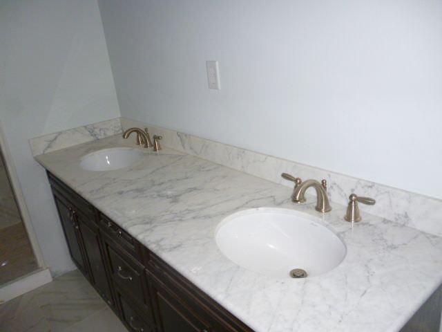

Steven Hockstein Posted October 8, 2012 Report Share Posted October 8, 2012 I have been taught that there needs to be a separate outlet for each basin. Today a licensed electrician told me that it is OK to share an outlet between basins. Can an electrical expert please assist me with an expert opinion on this. (NEC 210.52 ?). Click to Enlarge 23.75?KB Link to comment Share on other sites More sharing options...
John Dirks Jr Posted October 8, 2012 Report Share Posted October 8, 2012 I am not an expert but the central location between the two basins is an important part of the equation. Link to comment Share on other sites More sharing options...
Marc Posted October 8, 2012 Report Share Posted October 8, 2012 210.52(D): Within 3' of the outside edge of each basin. If they are within 6' of each other, one receptacle can meet that requirement. That's how I read it. Marc Link to comment Share on other sites More sharing options...
Steven Hockstein Posted October 8, 2012 Author Report Share Posted October 8, 2012 210.52(D): Within 3' of the outside edge of each basin. If they are within 6' of each other, one receptacle can meet that requirement. That's how I read it. Marc That is also what it seemst to me but now I am wondering why most of the local electrical inspectors are requiring a separate outlet for each basin, not one shared in the middle. I was thinking there may be something else I am mssing in the code. Link to comment Share on other sites More sharing options...
Marc Posted October 8, 2012 Report Share Posted October 8, 2012 Jersey has adopted the 2011 version of the NEC. My version is the 2008. Maybe there's been a change since then. Marc Link to comment Share on other sites More sharing options...
Richard Moore Posted October 8, 2012 Report Share Posted October 8, 2012 Jersey has adopted the 2011 version of the NEC. My version is the 2008. Maybe there's been a change since then. Marc Nah, the relevant line remains the same in 2008 and 2011... (D) Bathrooms. In dwelling units, at least one receptacle outlet shall be installed in bathrooms within 900 mm (3 ft) of the outside edge of each basin. I also read that as one being OK as long as it is within 3' of both sinks. I can see some interpreting that as one per basin but, if that was the intent, it would have been simple enough to use the words "per" or "for" somewhere in order to state it clearly. Having said that, it does seem a bit El Cheapo to only have the one in Steven's photo, but that's builders for you. Marble counters sell houses, receptacles don't. Link to comment Share on other sites More sharing options...

Jeff Remas Posted October 11, 2012 Report Share Posted October 11, 2012 210.52(D): Within 3' of the outside edge of each basin. If they are within 6' of each other, one receptacle can meet that requirement. That's how I read it. Marc Bingo Link to comment Share on other sites More sharing options...
