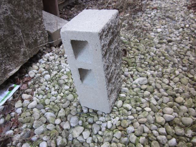

I wasn't sure what you were talking about so googled an image. It seems to show the problem. Does the split face take on more water than a standard CMU?
Click to Enlarge
7.59 KB
Posted
That's it, except take out the flashing.
Some of the block is almost spongelike, some of it is mildly moisture repellant. The largest problems come from the hairline cracks that are everywhere; it creates excessive capillarity.
So, no flashing, extreme capillarity = water in wall.

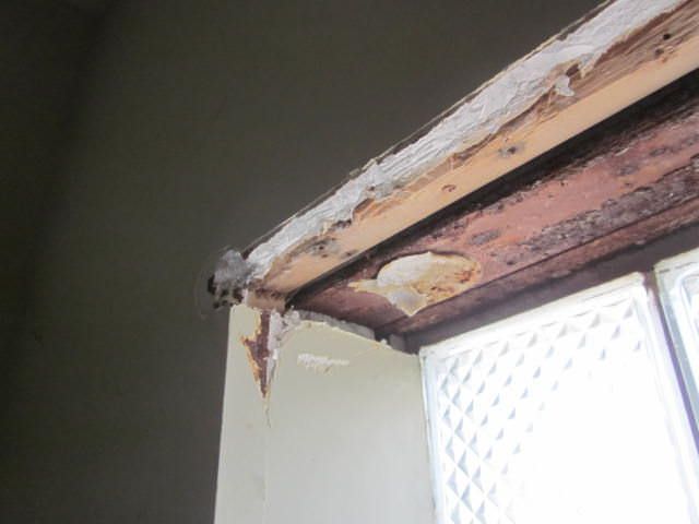

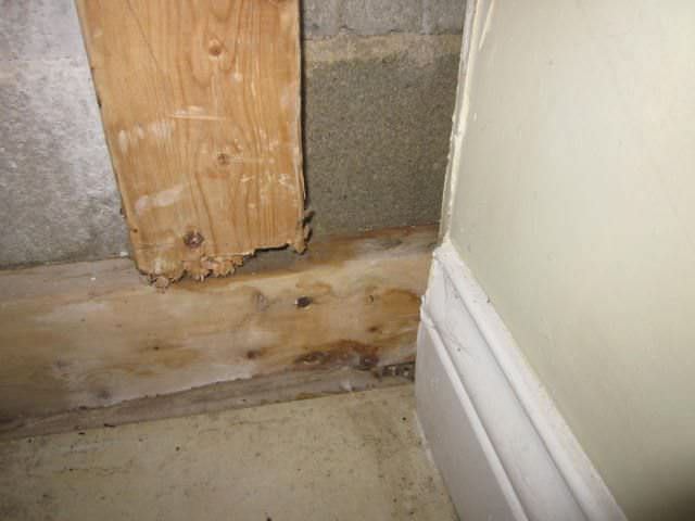

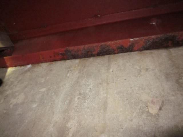

Yes it does and the problem is that anything in contact with the wall (furring, wood truss, steel) will absorb water as well. As a single wythe there is too much work/detailing for your ordinary laborer to keep a capillary break.
This building I looked at had de-humidifiers in three of the units. Good luck with that.
