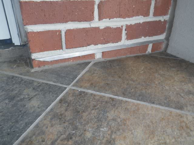

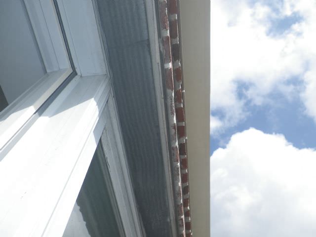

palmettoinspect Posted September 19, 2012 Report Share Posted September 19, 2012 This was a luxury condo complex in downtown Charleston. I wanted to share some of the brick detail pictures. Very rarly have I seen brick done correctly so I was taken back. It hard to believe how badly installed most brick is. Click to Enlarge 46.46 KB Click to Enlarge 52.43 KB Click to Enlarge 28.01 KB Link to comment Share on other sites More sharing options...

kurt Posted September 19, 2012 Report Share Posted September 19, 2012 Kind of a fine point, but the picture doesn't show any end dams. Maybe they're in there, but it's called through wall flashing for a reason; you're supposed to see the end dams. Link to comment Share on other sites More sharing options...
palmettoinspect Posted September 20, 2012 Author Report Share Posted September 20, 2012 Kind of a fine point, but the picture doesn't show any end dams. Maybe they're in there, but it's called through wall flashing for a reason; you're supposed to see the end dams. There were only visible end dams at the bottom of the doors but the pictures do not show. Did not see them anywhere else. Link to comment Share on other sites More sharing options...

kurt Posted September 20, 2012 Report Share Posted September 20, 2012 There were visible end dams at the bottom of the doors but the pictures do not show. Wow, then you really are in the rarified percentages. Almost no building I see has pans or end dams. Link to comment Share on other sites More sharing options...
