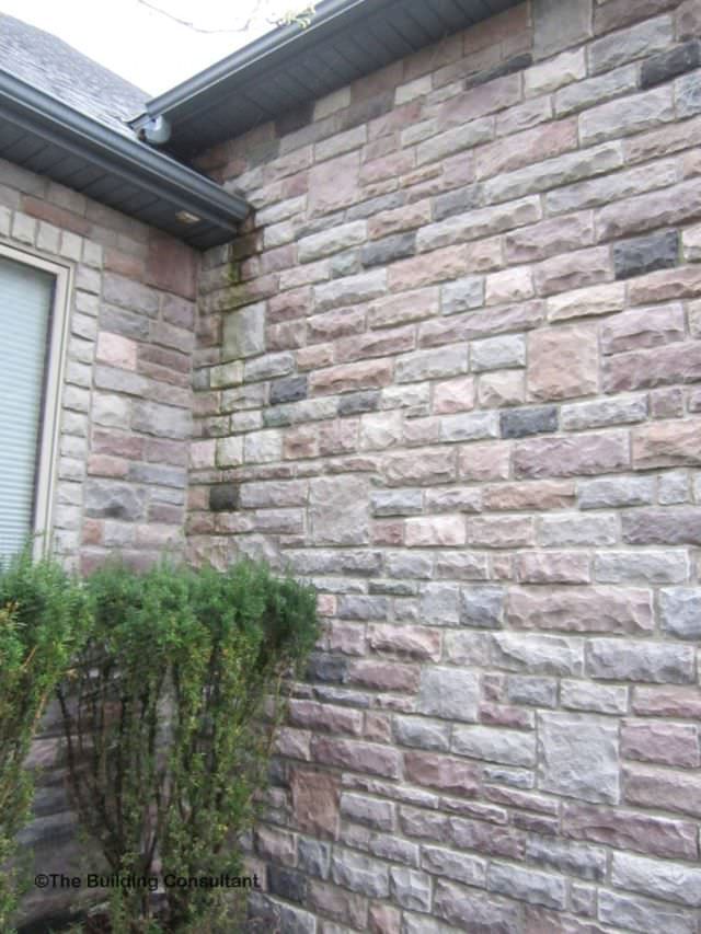

rjohns29 Posted September 3, 2012 Report Share Posted September 3, 2012 I am a looking to buy my first home and found a house I like. However, it looks like there are some major issues with the stone on the house. For example, the grout is gone is some places and the stone has fallen out in some places. Is this a serious issue, or a simple fix? Thanks for your help. Click to Enlarge 63.98 KB Link to comment Share on other sites More sharing options...

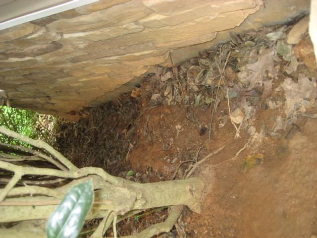

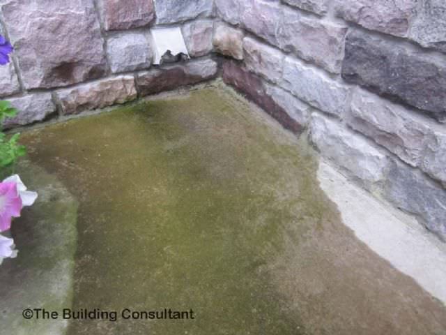

rjohns29 Posted September 4, 2012 Author Report Share Posted September 4, 2012 Yes it is. Also there is a problem with some erosion under the concrete at the front of the house. I will take a picture and post it tomorrow. Link to comment Share on other sites More sharing options...
Scottpat Posted September 4, 2012 Report Share Posted September 4, 2012 I am a looking to buy my first home and found a house I like. However, it looks like there are some major issues with the stone on the house. For example, the grout is gone is some places and the stone has fallen out in some places. Is this a serious issue, or a simple fix? Thanks for your help. Click to Enlarge 63.98?KB Hire yourself a good home inspector to take a look at the home. The faux stone is basically just stuck in place via a mortar bed. The grout is more decrotive than functional. Link to comment Share on other sites More sharing options...

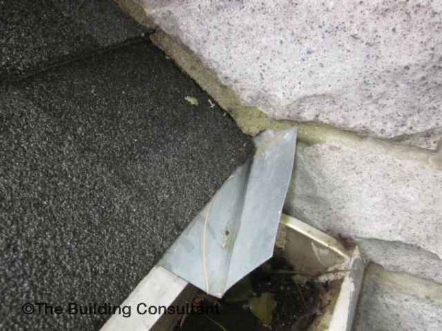

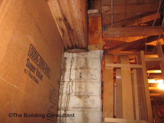

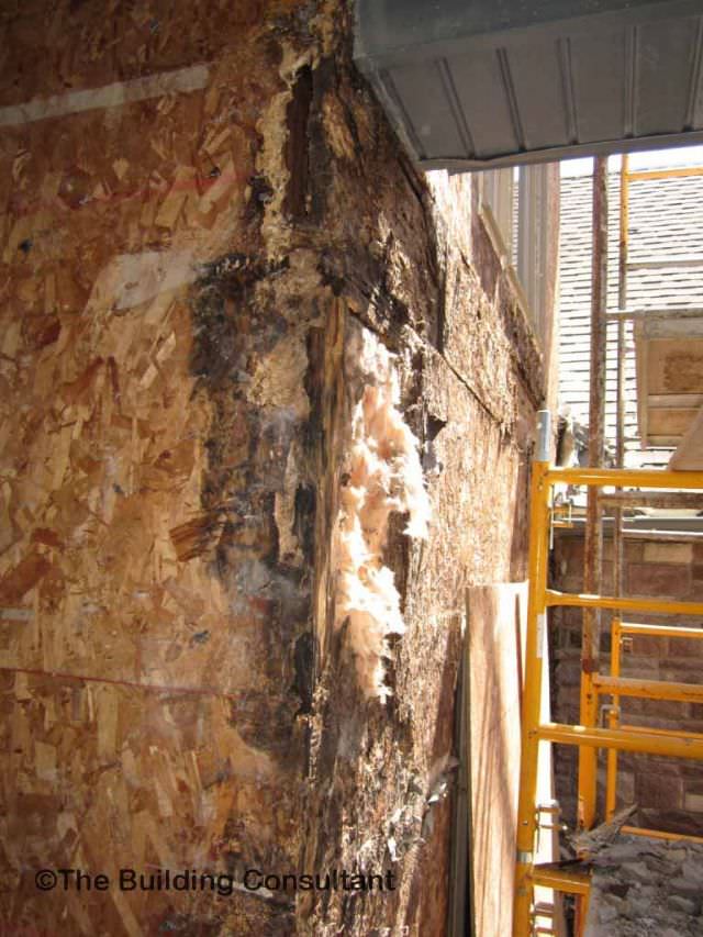

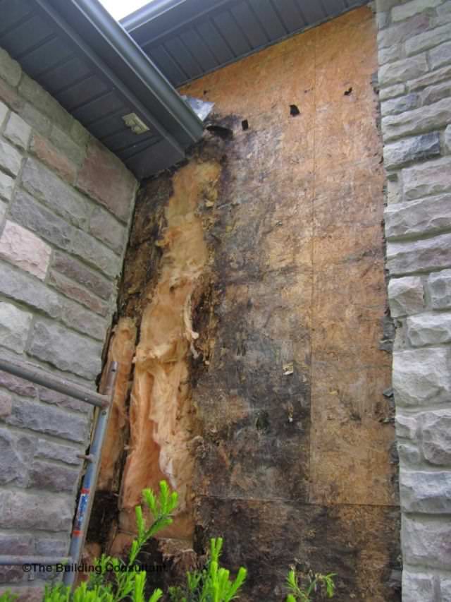

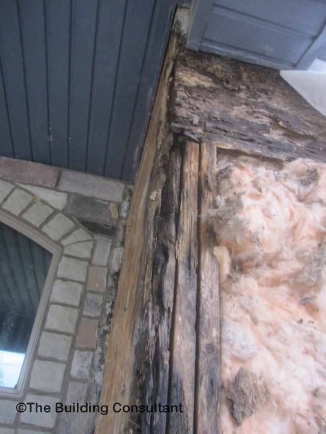

mark parlee Posted September 10, 2012 Report Share Posted September 10, 2012 Yes hire a good inspector that is familiar with the moisture damage that can hide behind Faux stone Click to Enlarge 108.22 KB Click to Enlarge 62.78 KB Click to Enlarge 43.97 KB Click to Enlarge 58.62 KB Click to Enlarge 105.63 KB Link to comment Share on other sites More sharing options...
Rob Amaral Posted September 11, 2012 Report Share Posted September 11, 2012 Nice shot Mark... ! Link to comment Share on other sites More sharing options...
mark parlee Posted September 11, 2012 Report Share Posted September 11, 2012 Don't encourage me. A lot wrong here, no visible evidence on the exterior. This was a twelve your old home. Click to Enlarge 70.24?KB Click to Enlarge 60.86?KB Click to Enlarge 54.54?KB Click to Enlarge 102.44?KB Click to Enlarge 60.09?KB Click to Enlarge 116.43?KB Click to Enlarge 71.31?KB Click to Enlarge 72.2?KB Link to comment Share on other sites More sharing options...
