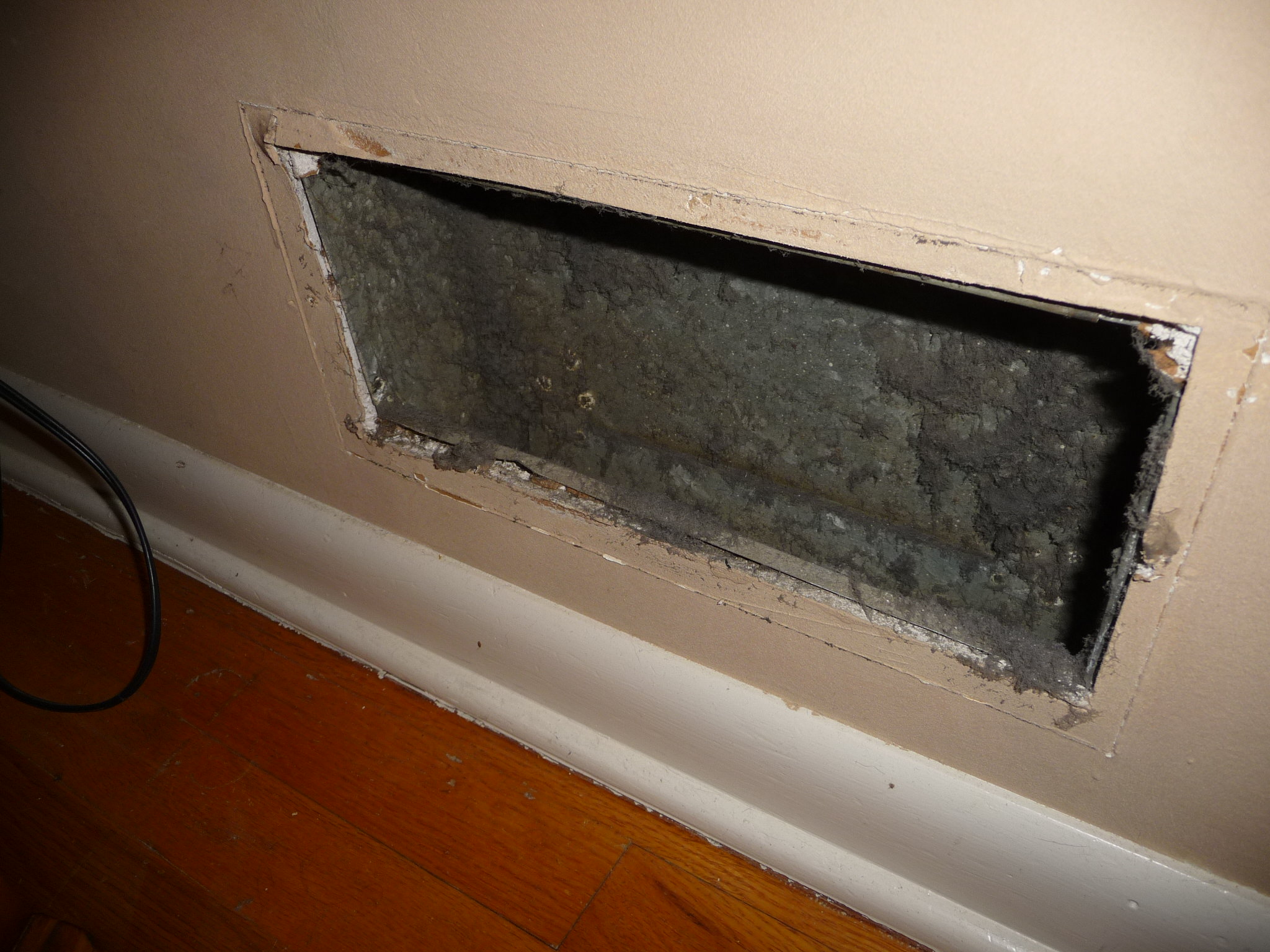

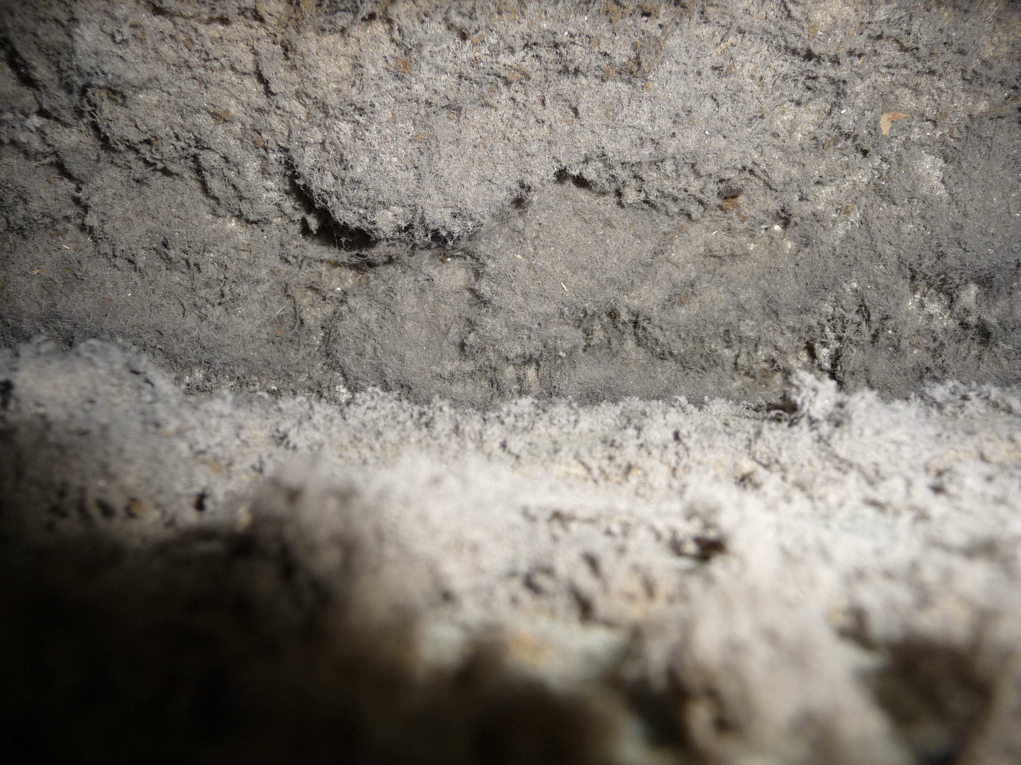

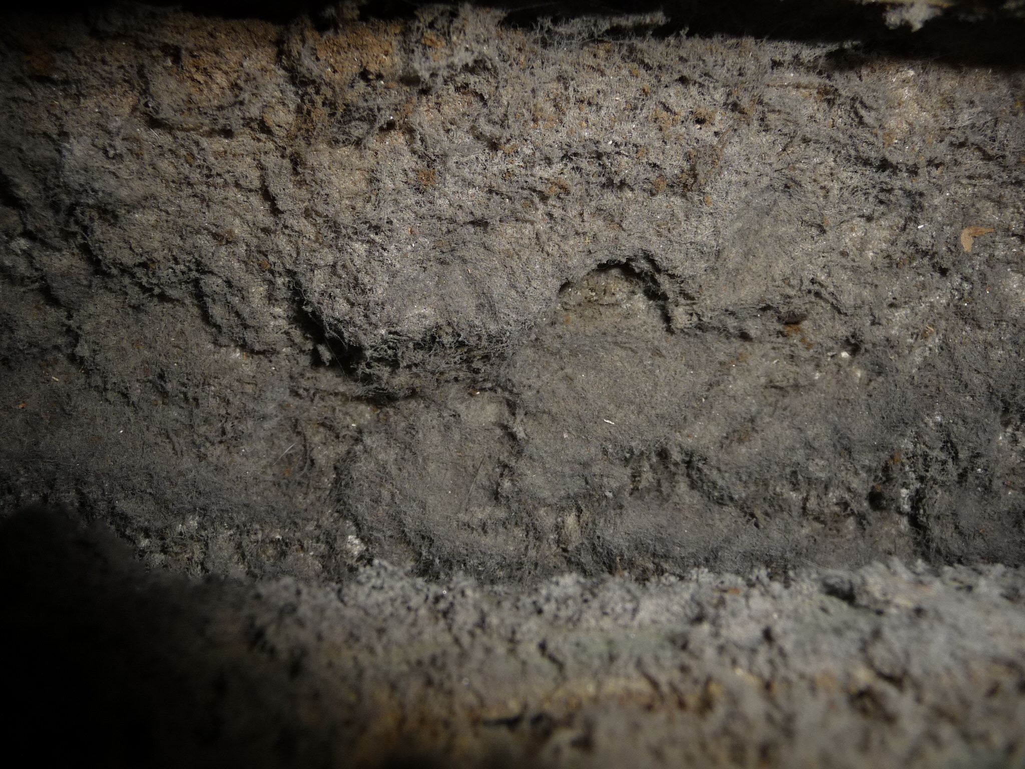

John Dirks Jr Posted September 1, 2012 Author Report Posted September 1, 2012 Here's some close ups from the return that's farthest from the air handler. The closer ones are worse. Download Attachment: P1290267.JPG 1561.15 KB Download Attachment: P1290268.JPG 1548.77 KB Download Attachment: P1290271.JPG 1605.68 KB

Marc Posted September 1, 2012 Report Posted September 1, 2012 John Dirks Jr said: Here's some close ups from the return that's farthest from the air handler. The closer ones are worse. Download Attachment: P1290267.JPG 1561.15?KB Download Attachment: P1290268.JPG 1548.77?KB Download Attachment: P1290271.JPG 1605.68?KB Great Scott!!! Get a professional! [:-paperba Marc
John Kogel Posted September 1, 2012 Report Posted September 1, 2012 At least it's just lint and dog hair. I found vermiculite in a return air duct in a house my clients had already bought. Nice.
ericwlewis Posted September 1, 2012 Report Posted September 1, 2012 John Dirks Jr said: Here's some close ups from the return that's farthest from the air handler. The closer ones are worse. Download Attachment: P1290267.JPG 1561.15?KB Download Attachment: P1290268.JPG 1548.77?KB Download Attachment: P1290271.JPG 1605.68?KB [:-yuck]
