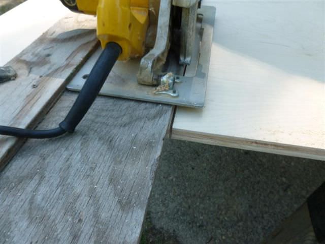

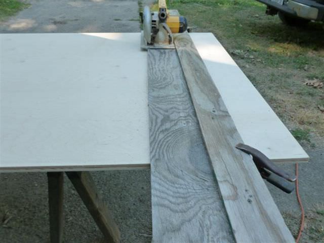

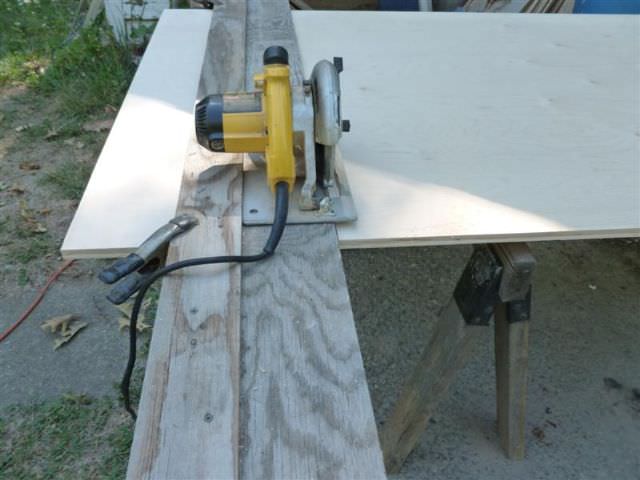

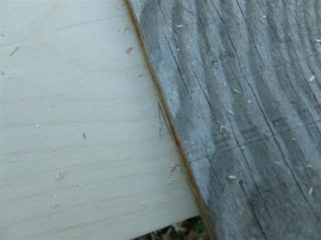

gtblum Posted August 7, 2012 Report Share Posted August 7, 2012 Whether you're carpenter or just a weekend warrior, sooner or later you'll need to cut sheet goods. I thought I'd share this jig you can make from scrap 1/2" plywood and hang on your garage wall until you need it next. You can make one in about twenty minutes. It can't come out of calibration, sets up faster than you can snap a chalk line, no measuring to the blade, and it's every bit as accurate as any panel saw you can buy. I build cabinets with it. I've also made these with 1/4" ply for making dado cuts with my routers. I'd like to know how many of you have ever seen or used one? Honestly. Seems like every time I ever showed up with on a job with it, everybody was as puzzled by it as I was the first time I saw one in action. Click to Enlarge 43.35 KB Click to Enlarge 33.27 KB Click to Enlarge 44.96 KB Click to Enlarge 43.79 KB When you make this, remember to put the factory edge where the side of the table of the saw contacts the guide. Make the bottom wider than you need. The first cut you make through it will size it to your saw, and is all the calibration you need. From there, you just measure and mark the sheet in two places like you would if you were going to try to chase a chalk line, clamp it to the marks, and go! Link to comment Share on other sites More sharing options...

hausdok Posted August 8, 2012 Report Share Posted August 8, 2012 Hi, I used to have one but tossed it a few years ago. About two months ago, as I was getting ready to cut some sheet goods I simply measured the distance from the edge of the saw blade to the edge of the base plate, added that to the length I needed, clamped a straight edge on that length-plus mark with a couple of C-clamps and used the edge of the straight edge with the base plate against it to make my cuts. Worked like a charm. ONE TEAM - ONE FIGHT!!! Mike P.S. If you use this method you have to keep in mind that sometimes you're going to have to subtract that distance and cut the other side of the line, depending on which side works best at the time. Make sure you use flat cabinet type clamps. I know I said C-clamps above but I meant to say cabinet clamps. Those are low enough to stay under the saw's motor as it passes by; C-clamps are too high. Link to comment Share on other sites More sharing options...
gtblum Posted August 8, 2012 Author Report Share Posted August 8, 2012 Hi, I used to have one but tossed it a few years ago. About two months ago, as I was getting ready to cut some sheet goods I simply measured the distance from the edge of the saw blade to the edge of the base plate, added that to the length I needed, clamped a straight edge on that length-plus mark with a couple of C-clamps and used the edge of the straight edge with the base plate against it to make my cuts. Worked like a charm. ONE TEAM - ONE FIGHT!!! Mike You could have made a new one and the cuts in the time it took to do all of that. That's the point of it. Try it if you want. Just sharing something that makes sense and saves time. RE. the ps. No you don't. Put it on the correct side of the cut. You get what you marked. Link to comment Share on other sites More sharing options...

John Kogel Posted August 8, 2012 Report Share Posted August 8, 2012 Thanks, Gary. I like the way you describe the thing, made to fit by the first saw cut. I had to rip some floor boards last week, could have used a jig. I did clamp the boards to the edge of my table, but then I just eyeball the pencil line and dive the saw over the clamps. Sometimes, I will go left-handed so my body is on the blade side where I can see the cut better. But that's not for right-handed folks. [] Link to comment Share on other sites More sharing options...
emalernee Posted August 8, 2012 Report Share Posted August 8, 2012 I mark mine with the saw and brand of blade that made it. Found out my saws and even different blades have different measurements between the edge of the shoe to the blade. Link to comment Share on other sites More sharing options...
hausdok Posted August 8, 2012 Report Share Posted August 8, 2012 You could have made a new one and the cuts in the time it took to do all of that. That's the point of it. With respect, Gary, As I said, I had one. Once you've done it once, It takes exactly the same amount of time to measure, clamp and cut a straightedge to the piece as it does to measure and clamp your jig to the piece. Heck, even with my lousy math skills I can add 3-3/4 inches to a cut to get my clamp tics in the same time as I'd measure out for the jig. I agree with you, it's a neat jig. I made mine based on an article in Woodworker's Journal sometime back in the 90's, but it just kept taking up space in the corner of the garage so it had to go. I have a nice thick aluminum drywall straightedge and it works just as well. You say to-may-to, I say to-mah-to. ONE TEAM - ONE FIGHT!!! Mike Link to comment Share on other sites More sharing options...
gtblum Posted August 8, 2012 Author Report Share Posted August 8, 2012 I forgot to mention. Since the weight of the saw presses the bottom of the guide tight to the material, there's no chipping on the good side of the cut. That goes for counter tops, sheet laminate, doors, and anything else you would normally need to waste time taping. I mark mine with the saw and brand of blade that made it. Found out my saws and even different blades have different measurements between the edge of the shoe to the blade. Exactly. My router jigs are labeled. I've been building cabinets with these since I first saw one about fifteen or twenty years ago. I can't afford to take a chance on making a slightly inaccurate measurement. Link to comment Share on other sites More sharing options...
